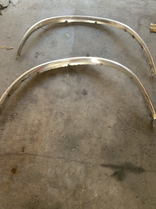

Chrome Wheel well trim - not in the best shape, previous owner ran self tapping screws through them. Can label what wheel well each one goes to before shipping. - SOLD

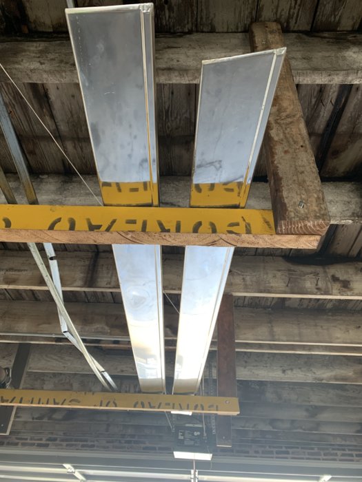

Rocker panel chrome trim pieces - couple small dents (one on each of the long middle pieces) nothing that can’t be fixed with a dead blow hammer and rubber mat. Will ship for $70

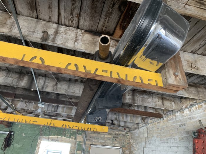

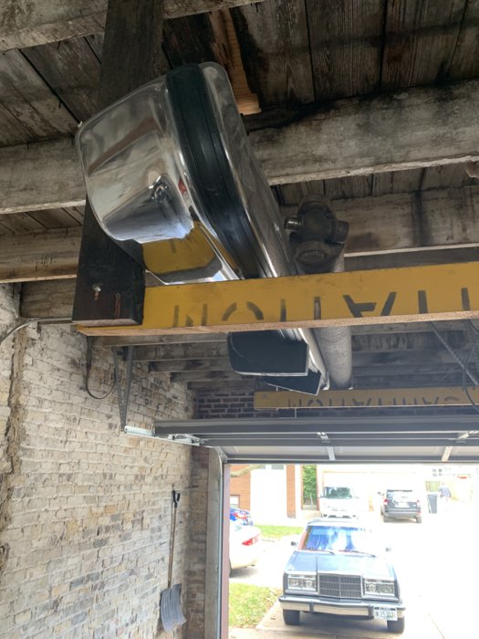

Rear bumper, Nerf strip - clips are all intact, minor scratches, looks really good over all. Will ship for $40

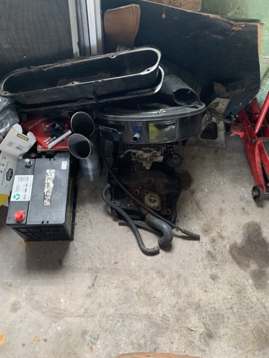

Factory valve covers - Buyer pays shipping
Factory 2v intake with carb - Buyer pays shipping
Factory air cleaner (lean burn computer removed) - buyer pays shipping

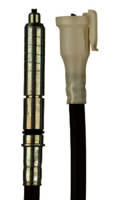

Without cruise, the cable you want is the Pioneer CA3030 or the ATP Y891 – which fits most rear wheel cars made (without cruise) from ’76-89 (except for the early F/M’s)
It will be ~80-81 inch long (depending on which way you measure it) with these two ends on it:
