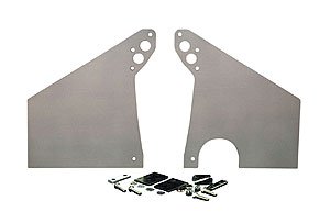

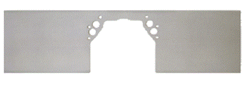

I was referring to the single or dual plate versions:
If you need motor plate(s) – then you don’t need P/S or any other luxury systems weighing you down.
I love the idea on cutting/machining down the water pump housing!
When doing so, don’t forget to also include the thickness of the second water pump gasket (sense gaskets will be doubled)!

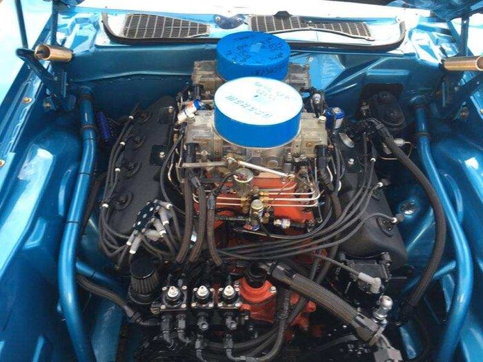

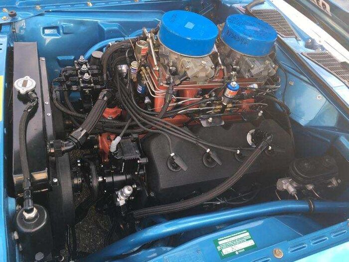

I run a front and mid plates on the street. No interference with headers or anything. The good thing I have the coil and everything mounted to the front plate. Really cleans up the engine bay.
