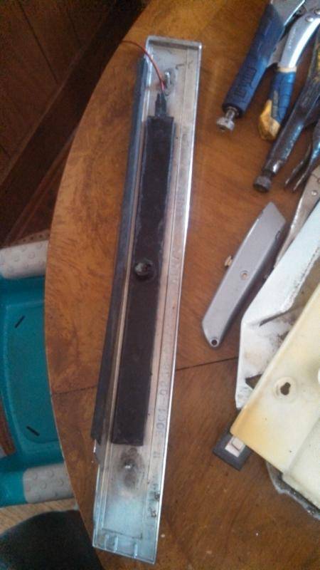

Ok, so the installation was pretty straight forward. A couple minor things to look out for, but other than that went very smoothly.

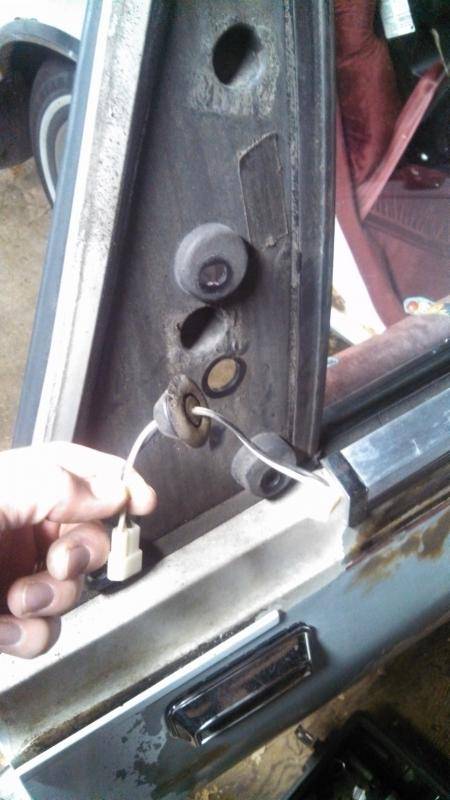

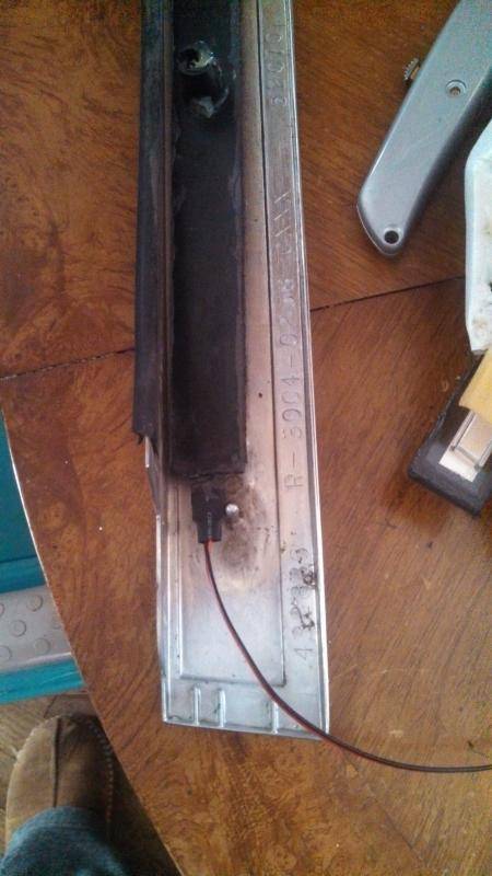

I just popped this out to use for splice into with the new kit wiring.

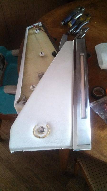

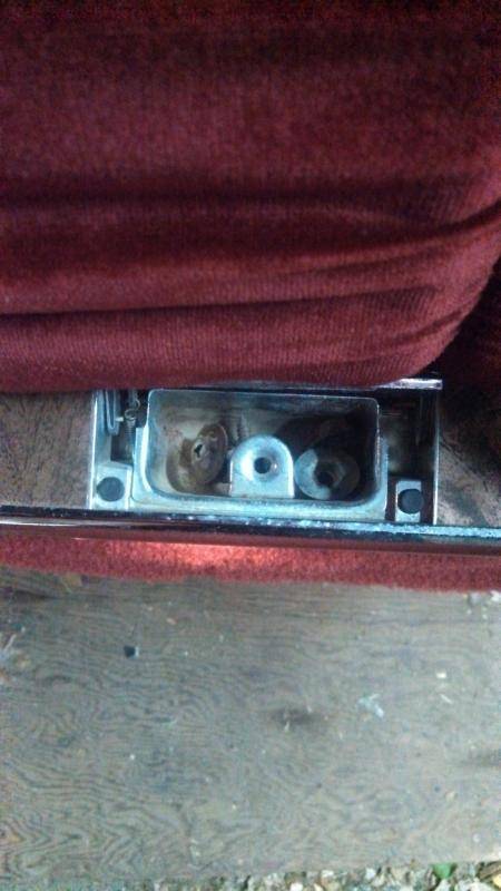

I like to put the fasteners in the ashtray. keeps them in one easy to find place, and I can keep each side's separated from each other.

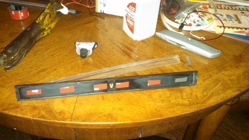

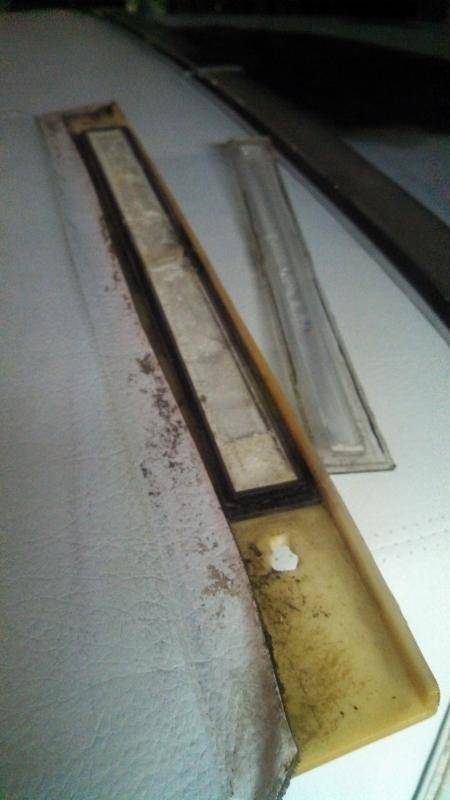

Have to be careful removing the clear plastic cover. It looks like they were either joined with heat, or some kind of chemical process, either way they're melted together. That and mine were a bit brittle with age.

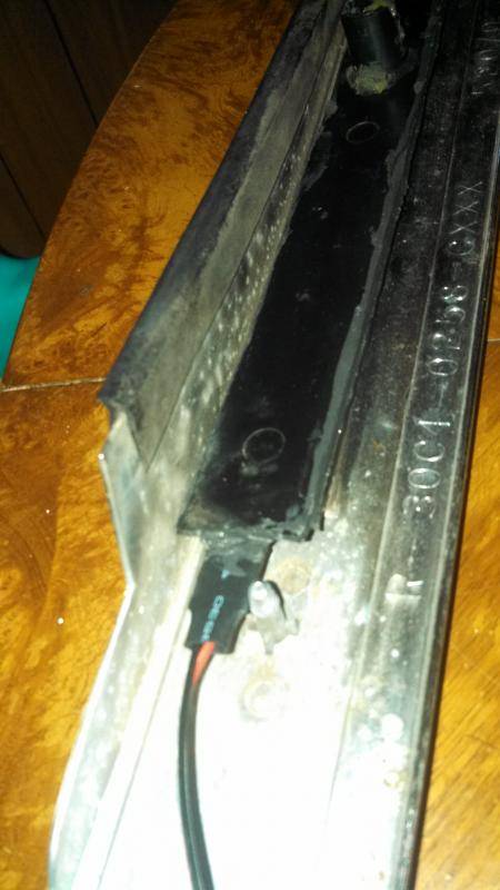

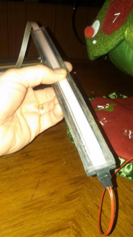

Test fitting, the replacement strip isn't as wide as the original, so it's important that it's centered in the housing. As you can see, I bought the cut to fit piece, and planned to run the wire out the bottom (more on that later).
I just trimmed the end off to fit with a pair of scissors, and used the 3M mounting tape to secure it in place.

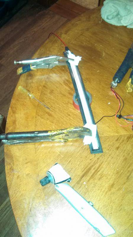

I used RTV Black around the edges, because it's tough, rubbery, will form a nice watertight seal, and unlike silicone will also be resistant to heat and temperature changes for many years to come. just a little cheap insurance. Again I had to be careful with how tight I clamped these since they're becoming brittle with age, and exposure..
This is the other side, as you can see I just cut thin strips of the mounting tape and set them in a row.
This is the problem I ran into with trying to run the wire out of the bottom, easy enough fix..
I just flipped it and have the wire running from the top, I doubt anyone would ever know the difference.

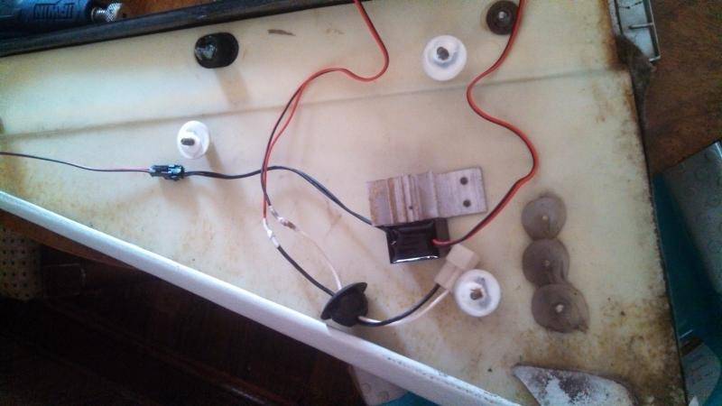

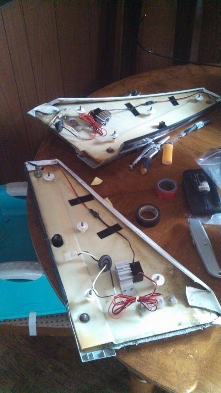

Test fitting, you can kind of see where I drilled the hole for the wire on the top of the one in the background.
I decided to just mount the new inverter next to the old heat sink. Another important point, if you're going to splice into the old connector, (and why wouldn't you?) black is positive, and white is ground for some reason.
Neatened up a bit, I put more RTV on the connectors that are between the electrical tapes, only because it's likely to be exposed to water, and I don't want that corroding.

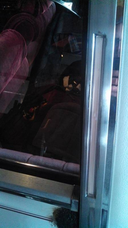

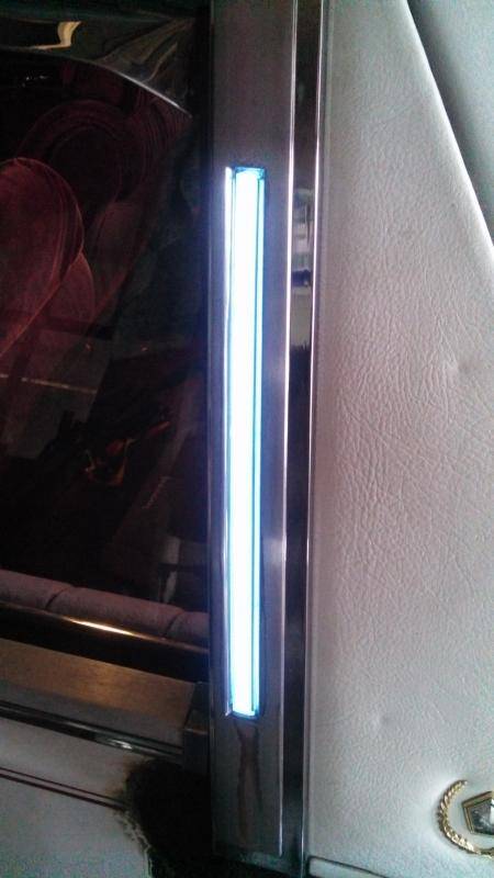

All buttoned back up, and working like a charm!
Trashy, but Classy!

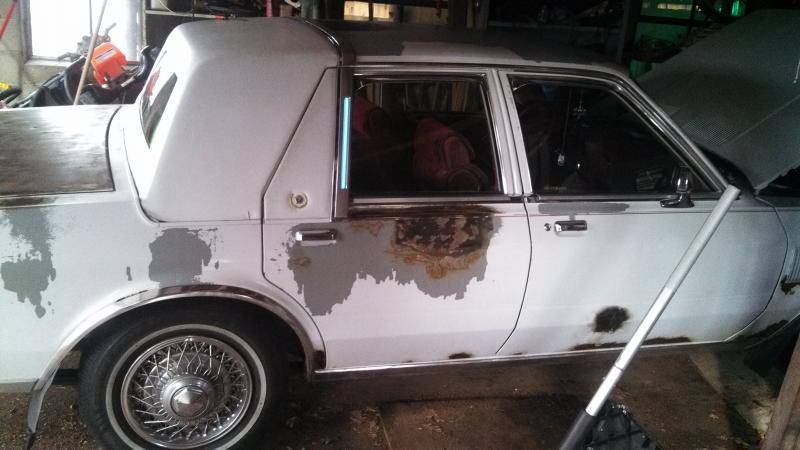

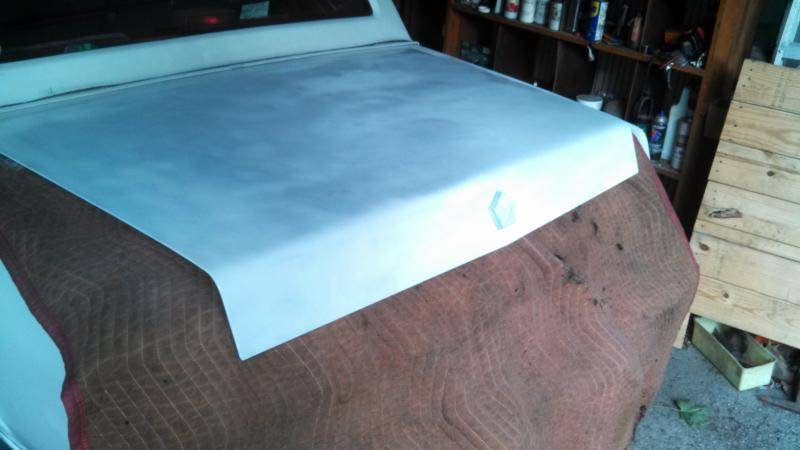

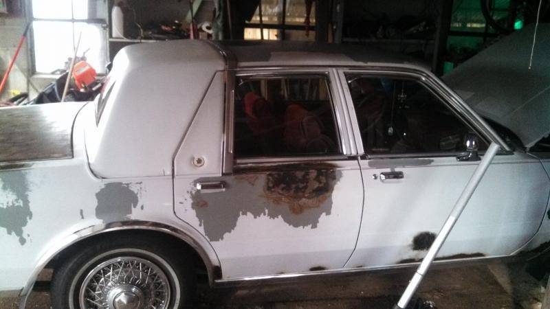

This is my latest foray, I've gone through multiple cans of rust converter, the stuff sprays on clear then turns the rust black. Works best on surface rust, but the rust can't be too thin either or the converter doesn't have enough molecules to adhere to the metal. I'll take a few pics of areas I haven't sprayed over with the white yet.
Which brings me to, I didn't want to just put a coat of lacquer on, I wanted something tougher to try and keep the rust from reforming. I was looking for a white epoxy paint when I found this ceramic based engine paint. It goes on kind of rough, but it seems hard as a rock. It's kind of a flat white, but it's certainly an improvement over the rust. I'm pretty sure I could eventually sand and paint over it, but for now I'm debating covering the whole car in it and seeking how well it holds up..
