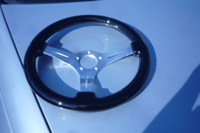

debating what (excuse the pun) direction to go with the steering wheel.. I found a few different grant walnot ones, but they also have some cool (imo) chain ones.. it's definitely the centerpiece of any build, and dramatically changes the atmosphere of the car. the chain wheel would go well with a nasty 390, for sure. on the other extreme, the wood one would lend an air of dignity to a smooth running overdriven injected magnum 360.. such a simple thing, but a pivotal point..

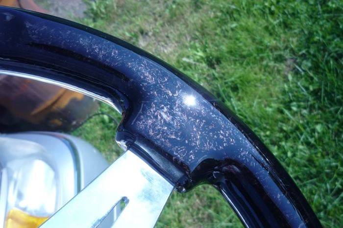

I put this grant wheel in my 5th ave
It was originally woodgrain, but didn't like woodgrain in my car and painted it all to look like marble

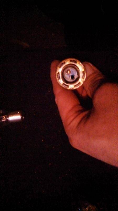

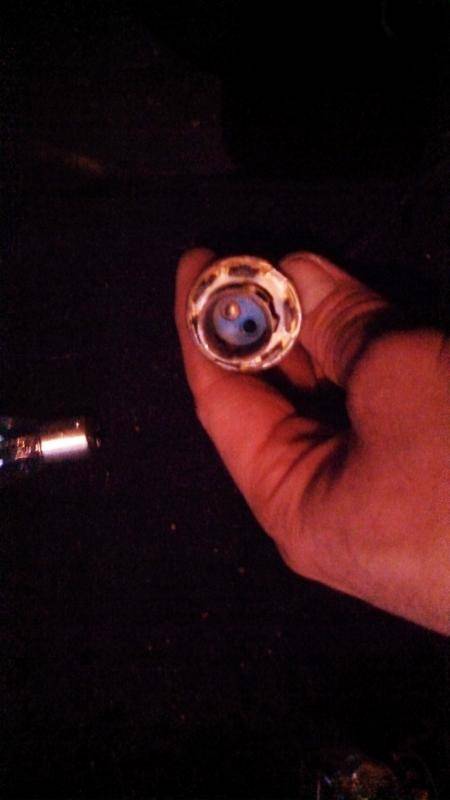

I'll have to take some pics when I get home. The 3 wire sockets I found aren't mechanically compatible with the lense housing. As in the 2 wire sockets are a different design, from what I can see. I'll take another look, but I'm not seeing how the 3 wire socket will plug into the opening for the 2 wire one. does that make sense?
Monkeyed
Apr 3, 2014
701
76
West MI

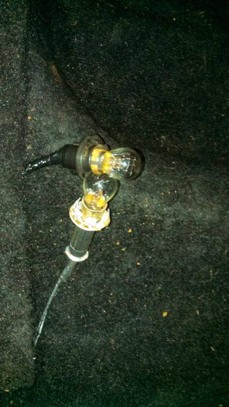

The 3 wire socket is on the top, and the 2 wire is on the bottom, kind of hard to tell in this pic, but they're different. Maybe they're the same as each other on yours?
inside my 2wire there's a blank hole that can be made to convert it to a 3 wire
here's a slightly different angle.
