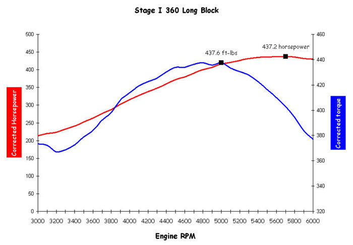

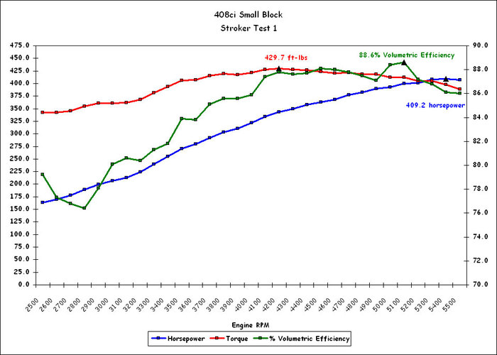

Here is a sort-of clone to my engine, that Hughes built a few years later. Theirs is slightly different;ported iron heads vs OOTB Eddies on mine.And I have the same 230cam, but with 10.9Scr
But I am such a huge fan of cylinder pressure, that for a streeter and in an A-body;that I would sooner put aluminum heads on a 360, with the pressure jacked up to 185, than have an iron headed stroker, especially in NZ, where you say the gas is crap.
The above is ported 596 iron heads and a 230 cam, with no compression specified, as far as I can see.

Hughes Engines
Take a look at the above two graphs, and compare the curves. Point for point. If you were to overlay them, there would be very little difference in these two engines.
From what I can tell, iron headed strokers make similar power numbers to hi-Compression aluminum headed 360s, Sometimes the 360 needs the next bigger cam to make similar power on top. And the stroker usually makes a lot more torque sooner, and slightly fatter throughout the midrange.
This allows the stroker,usually, to run one or two rear gears smaller to the 360 for similar low speed performance.
