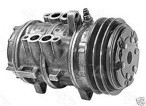

The A/C has a few more things involved.
The cast iron RV2 compressor (aka: the boat anchor) is bullet proof but also weighs a ton.
The aluminum C171 (or aftermarket Sanyo) is lighter and takes a bit less horsepower to rotate (when on).

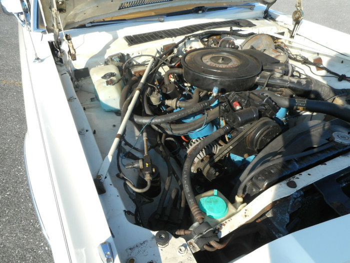

This is a '73 Body with a Sanyo (aftermarket) kit installed. This is a popular kit, if a person doesn't want to look for OE or original parts.
Either system does add weight to a car as well as rotational mass (pulleys, clutch, belts, etc.) so adding A/C might not be good if racing the car.

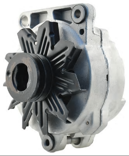

If looking for used pulleys/brackets for the C-171, there is two different versions.
One is the ’78-87 version, that uses the older style alternator.
And the ’88-92 (pre-Magnum) that uses the newer style alternator.
The new style will put out more amperage (if existing wiring allows for it – don’t burn your car down due to over-amping the wiring) and it has an easier way to tighten the drive belts. Pickups and vans might be the easiest ones to find brackets for.
There is also the ’78-87 bracket set that uses the 100-amp alternator, but that is bulky, heavy and not needed for a car like yours.
I do recommend getting both the pulleys, brackets (including alternator bracket(s)) and all bolts – just so you are not missing anything.

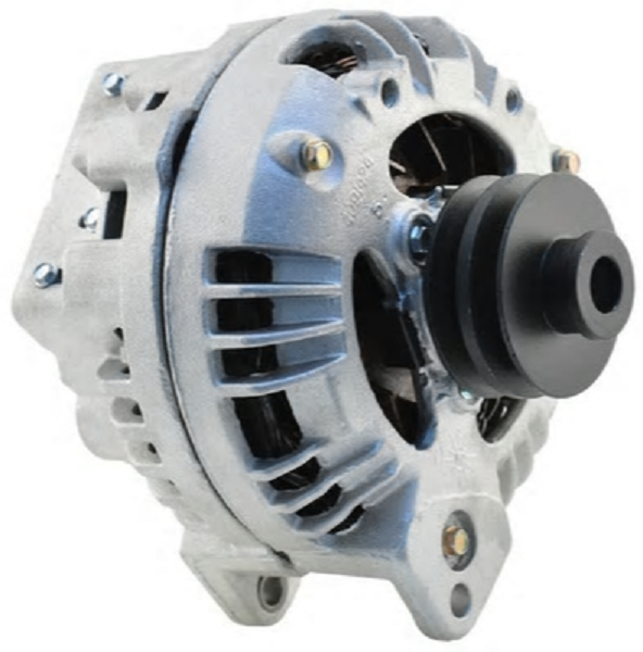

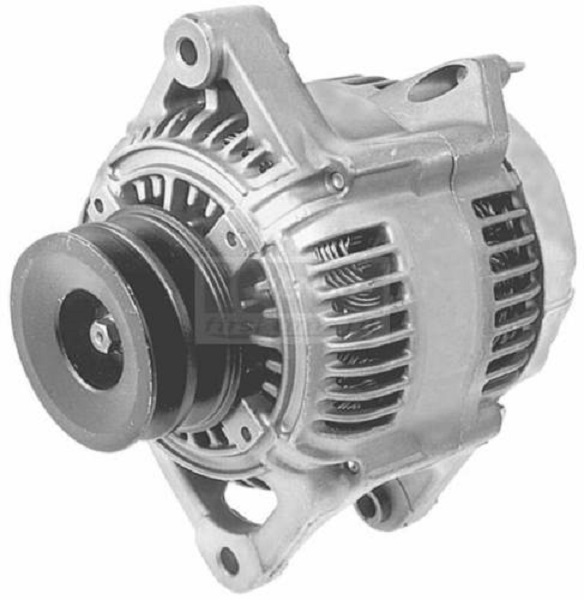

The alternator pulley will need a double-belt pulley. If your alternator currently has a double-belt pulley, then you are set. If not, either get a pulley (and pulley puller/installer) or an alternator with a double-belt pulley.

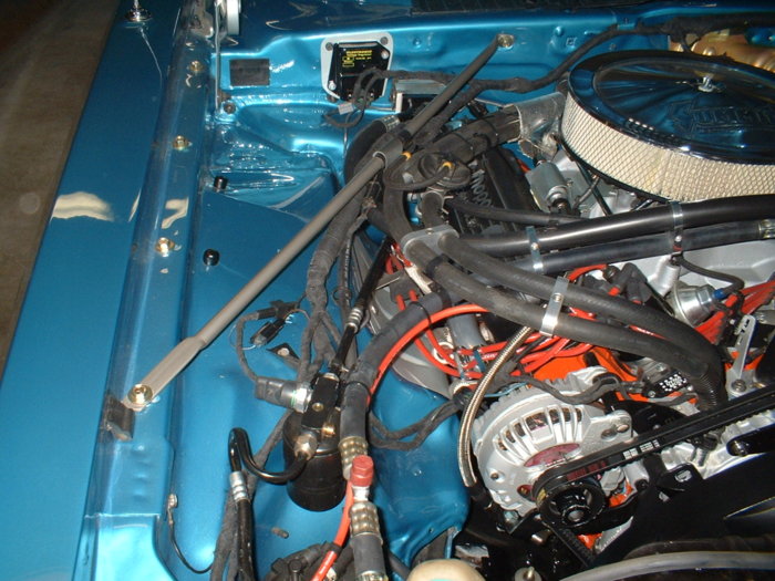

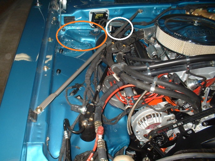

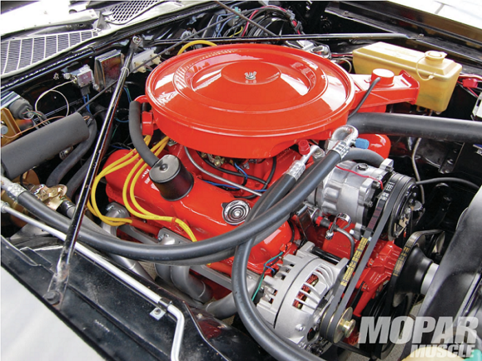

The ’80-89 FMJ hose that connects the drier/expansion valve/compressor is different than the ’78-79 FM versions. The ’78-79 version looks like Aspen500’s car where the expansion valve is level to ground. The ’80-89 FMJ expansion valve is tilted and hoses just don’t like being contorted to fit (they will fit, but some name calling might slip out, by accident – that kids might overhear).

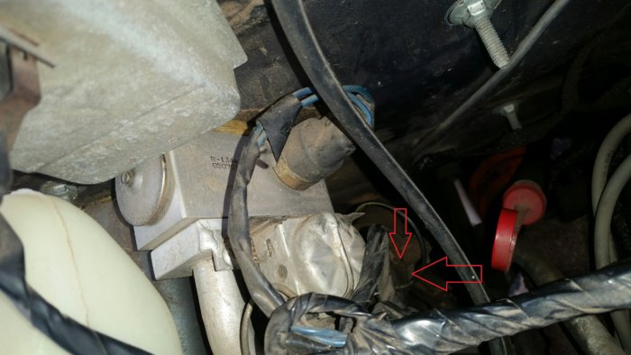

white circle is the expansion valve.

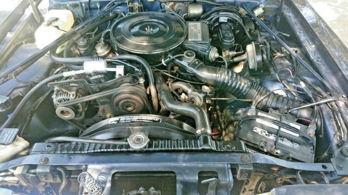

This is from my ’86 Fifth Ave. The angle is not good to explain things, but to help out, the voltage regulator is level and in same position (and angle) as Aspen500’s voltage regulator is. The arrows point to the ignition coil.

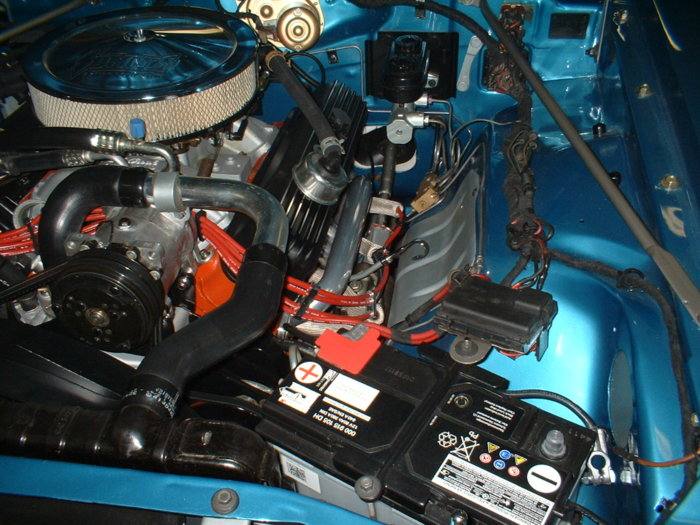

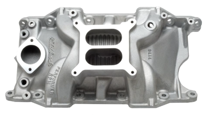

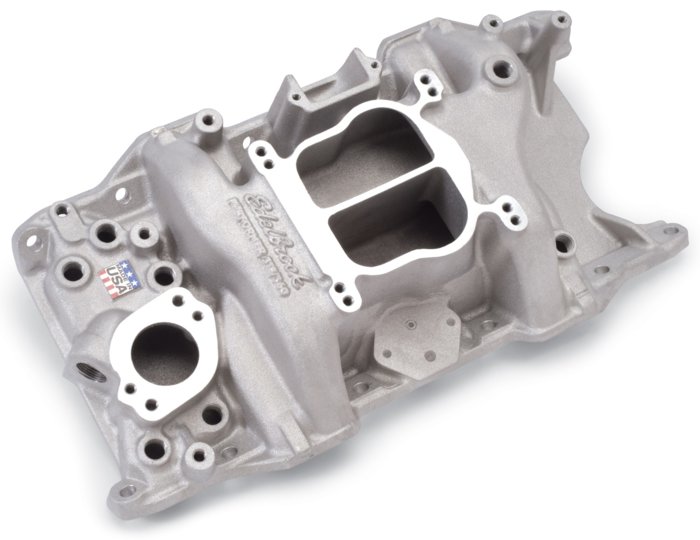

One last thing is the C-171 compressor uses a small block intake manifold that has the offset (to drivers side) thermostat. The RV-2 compressor is not as deep as the C-171 style is. The C-171 sits a bit off-center of intake and the rear compressor mount sits in same location as the older (center located) thermostat intakes.
I have seen people not install the rear compressor to intake bracket and still use the older intake, but you can feel the compressor is, um, not attached firmly after install. If not sure which intake you have, you can take a picture of it and it can tell you.
These pictures are not great, but if you look at thermostat hole in relation to the bypass hose hole, it helps.
This intake has a boss midway between thermostat and passenger side of intake for the rear compressor bracket.
Performer 2176. '78 and newer OE intakes are similar.
This intake has no boss nor will the bracket come close to fitting.
Performer RPM 7176. '77 and older OE intakes are similar.
