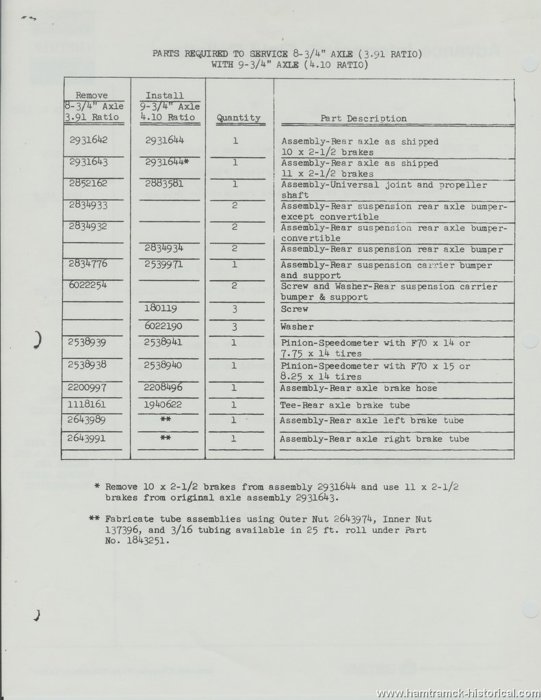

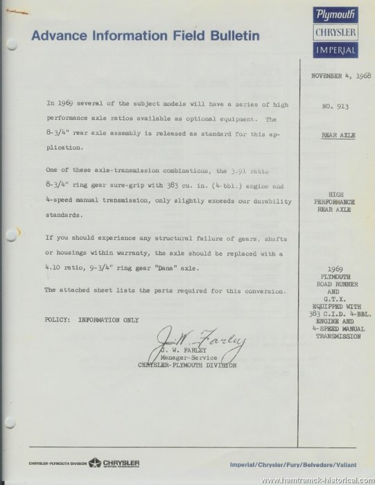

On a different but related note: this TSB is for ’69 Road Runners/GTX with 383 4-bbl, 8¾” differential and with a 4-Speed.
The TSB says “. . . The 3.91 ratio 8-3/4” ring gear sure-grip with 383 cu. In. (4-bbl.) engine and 4-speed manual transmission, only slightly exceeds our durability standards”.
It goes on to say “If you should experience any structural failure of gears, shafts or housings within warranty, the axle should be replaced with a 4.10 ratio, 9-3/4” ring gear “Dana” axle”.
I respect the Dana-60 differential – for it is one extremely tough unit – but expensive (and heavy).
After reading this TSB and looking at what some of the cars are driving now (500+ strocker big blocks) and using much much better tires than they had then – I wonder if the factory is trying to tell us to, um, go Dana 60?
