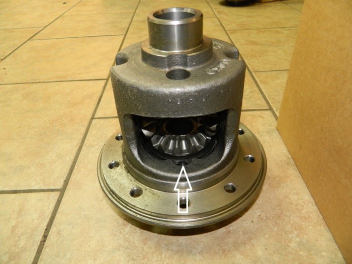

Clutch type (is rebuildable). Look for clutch notch (white arrow).

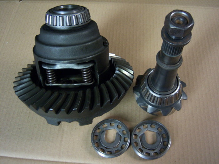

Cone type (is not rebuildable). Look for springs between the spider gears.

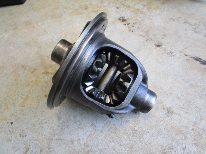

Open (non-limited slip) - for reference.

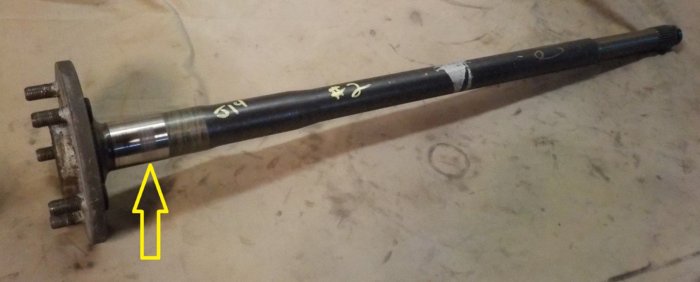

Another area to look for, during a rebuild, it to check for wear at the axle bearings (yellow arrow). If you can feel anything with your fingernail – not all is lost. Many years ago, anything caught with fingernail was trash (this one looks like could be that way, maybe). Now they have offset axle bearings – or axle saver bearings which a person can use.

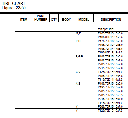

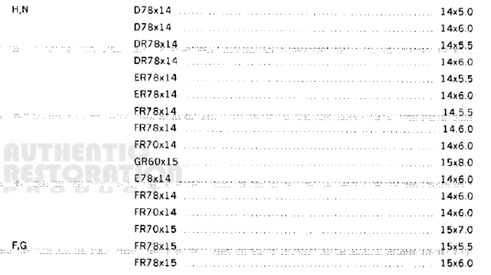

I don't what year car you have (and I do not have any manuals for '80 or 81 to look at). Here is what my '79 parts manual shows:
Tire size:
The speedometer gear is listed below (PDF file)
From my '82 parts manual (which PDF file is not easy to read or to interpret)
Again, the speedometer gear is in PDF file, below
