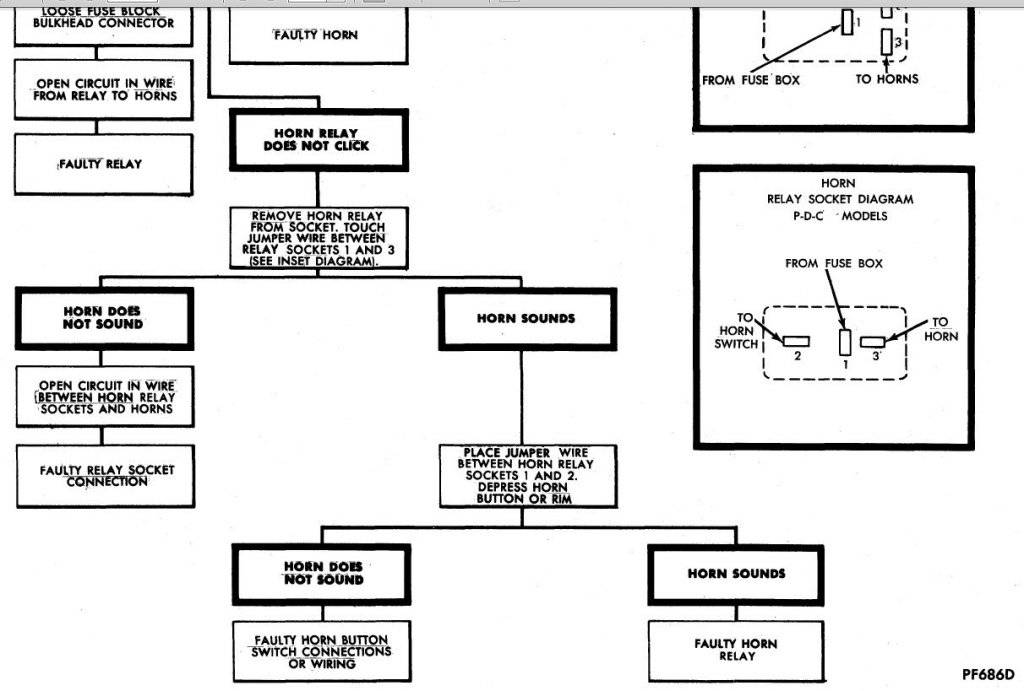

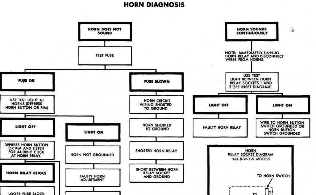

Hook up a test light to the horn wire, and have someone push on horn button.
The test light should only light when horn button is depressed.

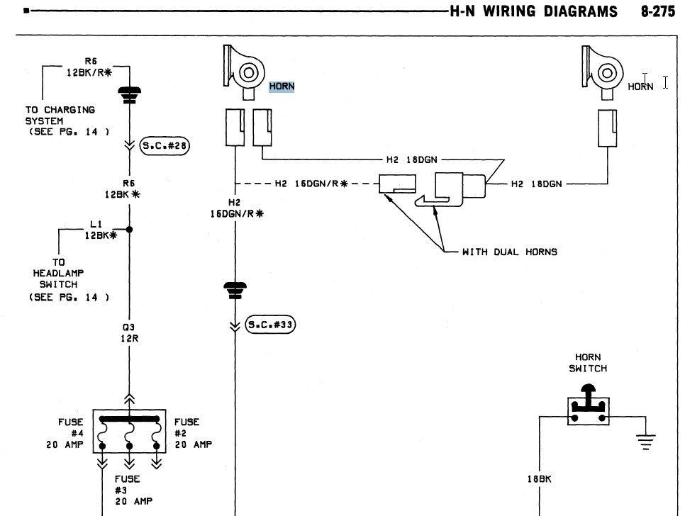

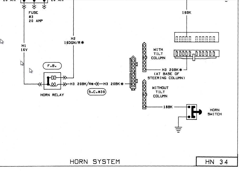

If it doesn’t then find the horn relay (in fuse box) and you may need to get a service manual – to find out which wire is coming from horn button.
The most likely suspects:
Blown fuse
Horn (or Horns)
Horn relay (in fuse box, by steering wheel)
Horn button.
Wiring harness is also possible, but unlikely.

Again, bud with the lifesavers. I havent run the light test, but when I push the button, i here the clicks. so i took out the positive wire and when i plugged it back into the horn with the button pushed, it clicked. Methinks im getting power to the horn but the horn itself is FUBAR. all the fuses are good. it was the first place i looked. :D It came stock with the one horn and as I said the new one is aftermarket. Guess ill have to order a new one, pending the light test results of course.

Ok so I know the horn is good. I ran a jump wore from the terminals to the battery. The buttons click when I press them so I'm sure they're good (I have three. What are the odds they're all bad?) How hard is it to get a new relay if that's the problem? If it was working the other day and just stopped would it be a faulty ground? Any electricians with advice would be splendid

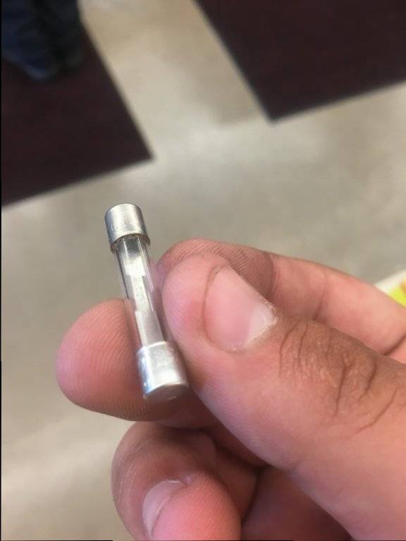

Here's the 20A fuse...seems fine
