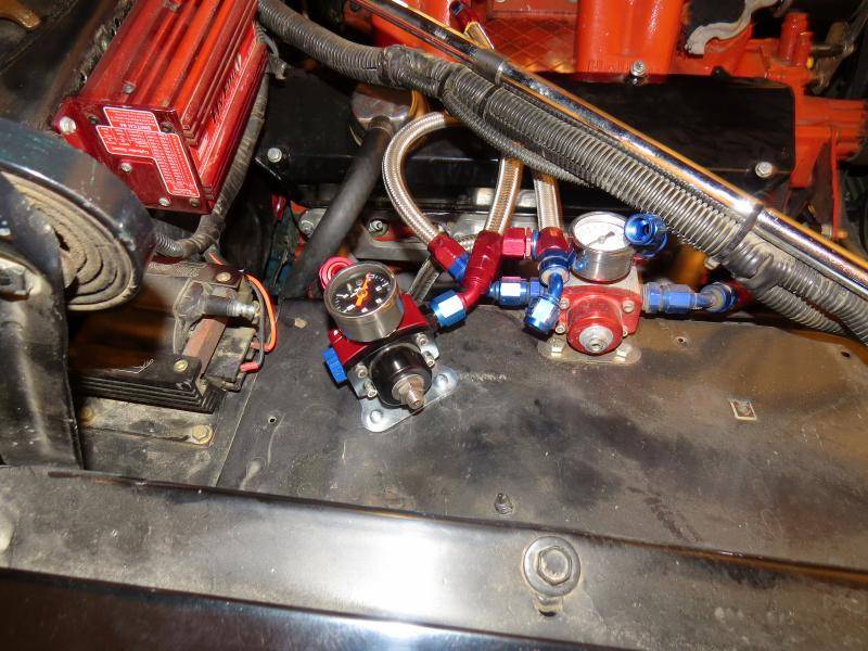

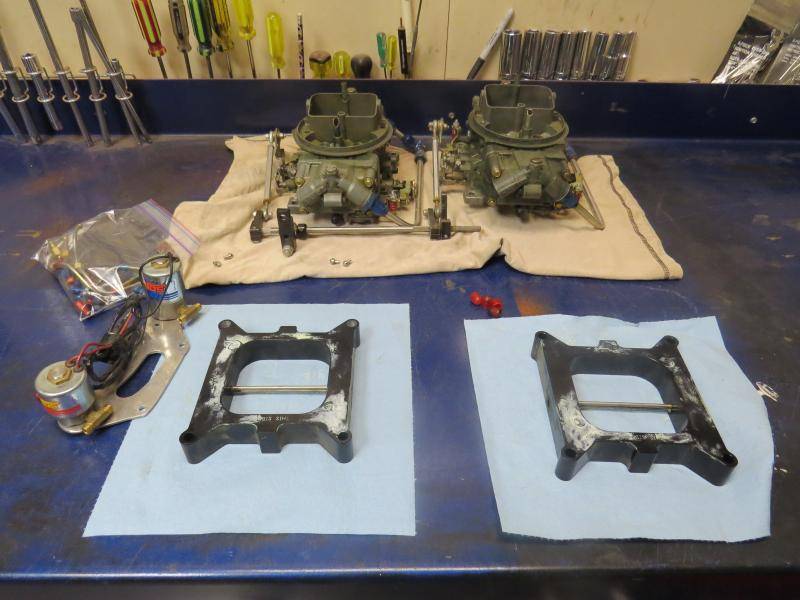

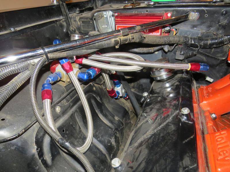

been busy in the garage today. got most of my AN fittings to plum the NOS system. I actually don't mind working with braided line. when it's finished, sure looks good. only thing i'm waiting on is the nos/fuel jet holders.
new 5 point harness is installed. every 2 years gotta get a new one. I got 5 old ones on the shelf.

nitrous purge kit is installed. just waiting on the jet holders for the plates to arrive. at a stand still without those parts. I wish they were here.
