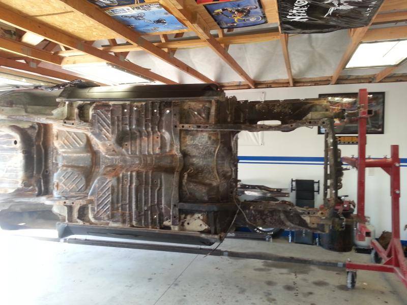

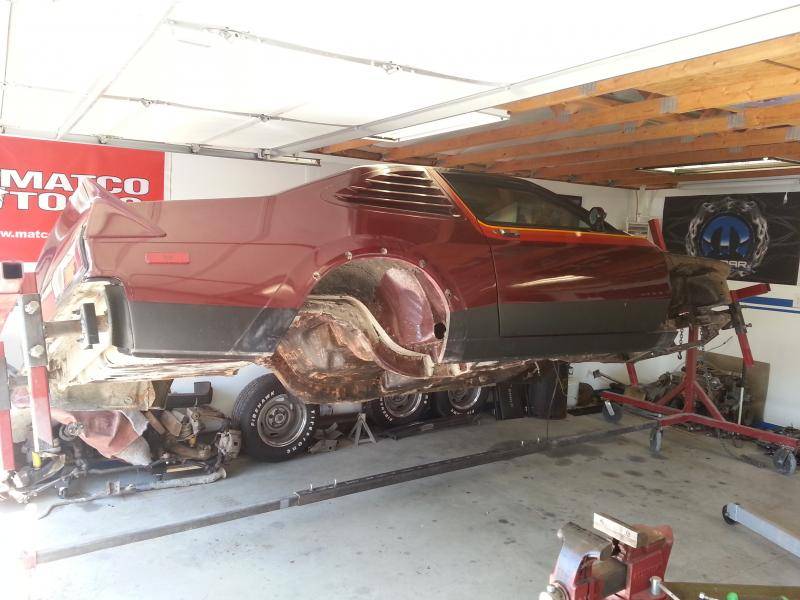

Buddy of mine offered me the use of his rotisserie.....SOOOOOOOOOOOOOOOOO much nicer than laying on your back!

My garage isn't very big, its about 23'x 23' with a 8' ceiling. Its real close when I turn the car up, and I will have to put it back horizontal to push it outside.
I was going to build my own rotisserie but when I figured up how much the steel was, I'm glad my friend offered me his. I had to fab up the mounts and the extension in the middle of the bottom rail. I bought 9' of 2 1/2" square and 5' of 2" and it was $83!

Seems like a real nice guy, I was having some trouble finding the center of gravity on the rotisserie, so I e-mailed him and he got right back with me and helped me out. Let me tell ya.....this is the ONLY way to work on the bottom side!
