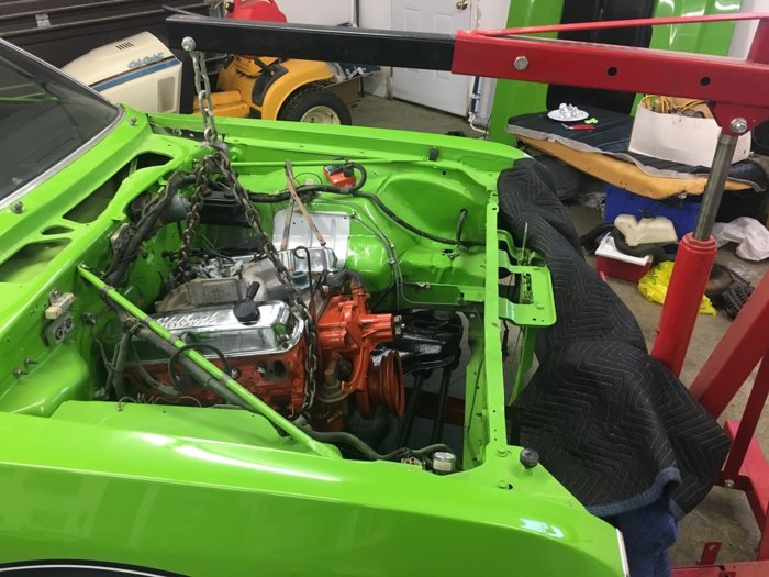

Hi, I am new to this site, some may know me from a different site. I am seeing the light at the end of tunnel on my 76 RR project that I bought in '09 from another F Body enthusiast some might know, this car was smashed bad in the back and hit in the front too. Well I had the body work done, then painted it myself, now I just installed a 318 & 4 speed. I am at the point where I need a fuel tank to make this thing run...alas the tank was destroyed in the accident so I have no fuel tank at all. I wanted to stay away from a fuel cell and go original, but I know the hump tank tanks are hard to find, if anyone has one to sell, it would be much appreciated.
76SassyGrassVolare
Nov 23, 2017
49
11
Ontario, Canada

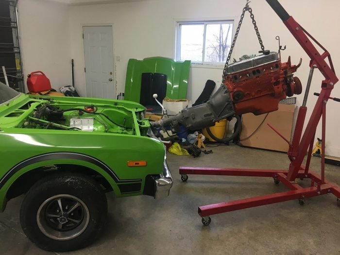

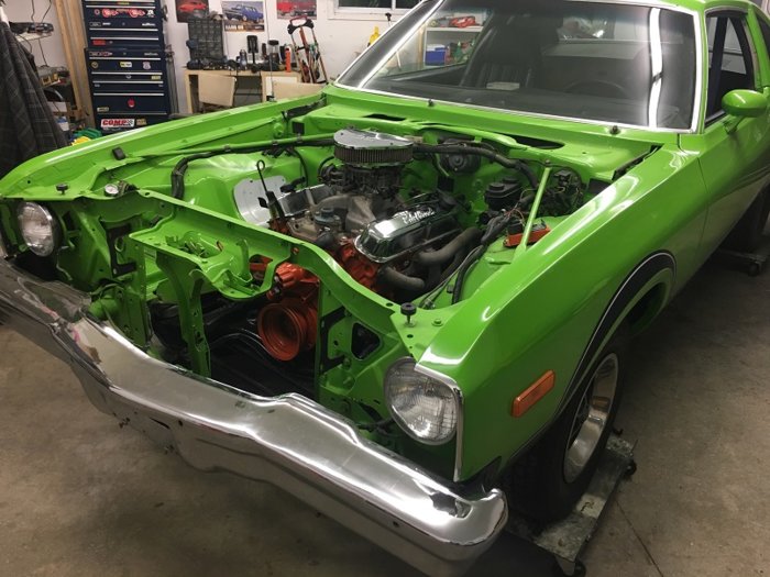

I installed the engine and tranny last weekend, got the headers and carb bolted on but I still have to button it up and get in running, need to install exhaust, distributor/ wires, radiator/hoses, hook up shifter, put fluids in everything, AND fuel! I have no fuel! ....this 318 is just temporary until I can build the 360 I have for it. I pulled this engine out of my '76 Aspen SE....

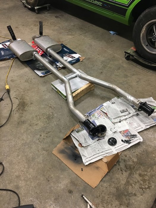

Well, did a bunch of little things. Tried to hook up the clutch linkage, I have never worked on a 4 speed and had no idea how it went together, I think I have everything together now, mocked up, I seem to be missing some small parts like the bushings that go in the z bar and the rubber washer thing for the clutch fork, but everything seems to be in the right place & I have some clutch pedal. Also hooked up all the shifter linkage and seem to be able to go through all the gears including reverse ok. I also installed the driveshaft (missing one bolt for the yoke ugh) and I mocked up the dual exhaust that came off my Aspen, looks like its going to fit and bolt up just fine (wasn't sure with different headers). This exhaust dumps before the rear diff, not my favorite style and I hope to switch it in the future, but its almost brand new and its what I have. As I remember in the Aspen, dumping the exhaust there can lead to exhaust fumes in the car, its not ideal...I made a punch out list to get this thing running and it is still quite long, but its just a matter of poking away at the list...

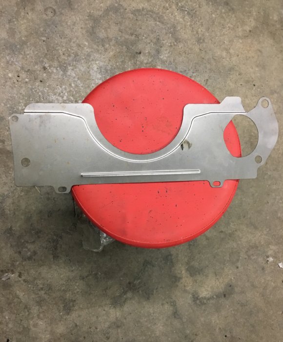

76SassyGrassVolare, do you have your lower bell housing pan close by?
I have one that I “think” is a small block – but don’t have any bell housings to find out what my pan fits. All I need is some measurements off of yours, please.

Last night I cleaned up the exhaust system I am using, had this made for my '76 Aspen in like 2007 and it was only on the car for a couple months and maybe 200 miles before I dismantled the car. It is not the ideal set up, I am not big on dumping the pipes before the rear diff, but I have it sitting right here and I don't have anything else right now. I just coated the collectors with Eastwood high temp satin black ( they were not galvanized or stainless). I found one collector gasket about 2 weeks ago but couldn't find the other one, was about to buy new ones, then found the other collector gasket in the trunk of the Aspen... like I looked in there 100 times but alas there it was like it just appeared, how does that happen?? Anyway I already test fitted this exhaust and it bolts right up to the headers perfectly... maybe I will get this on tonight...that will be another thing off the punch out list and one step closer to ignition!

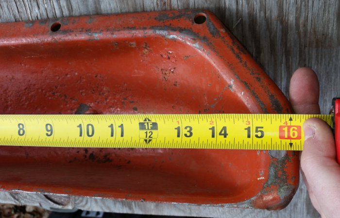

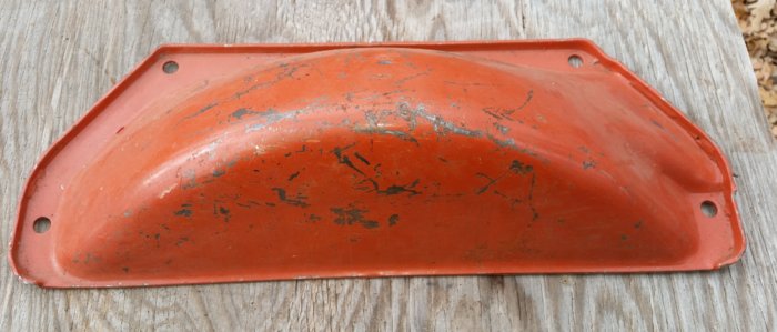

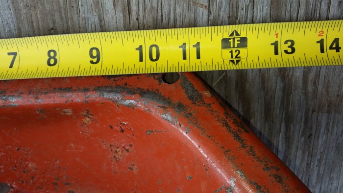

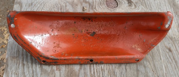

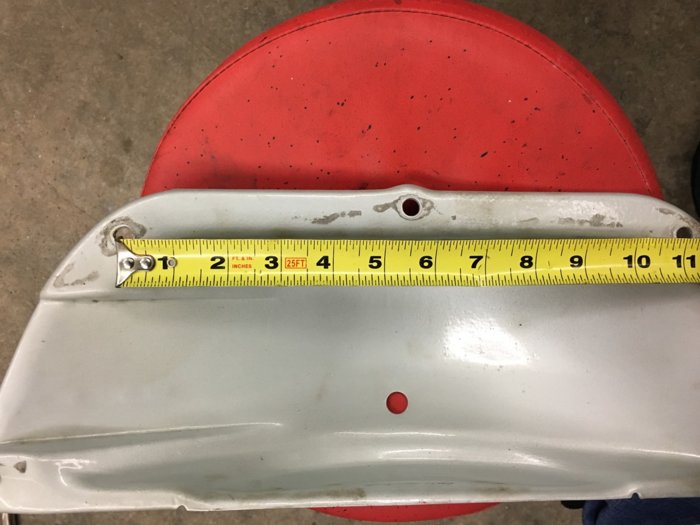

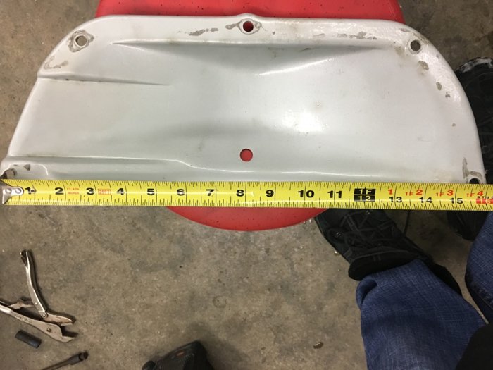

Here are some pictures of my lower bell housing cover – which I suspect is for a small block (but not 100% sure).
15-7/8” center of hole to center of hole.
10-3/4” center of hole to center of hole.

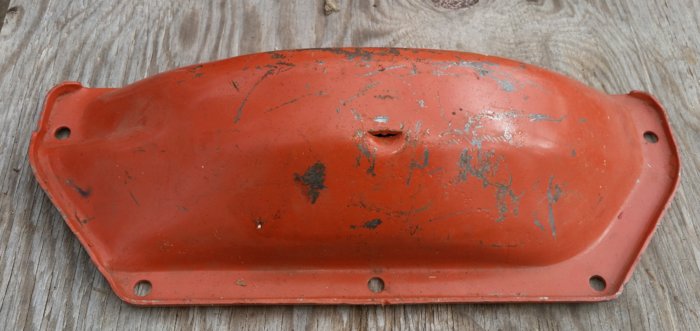

I dunno mine looks physically different, the measurements are similar though, I dont know much at all about manual Mopar trannys, maybe it is from a different manual not an 833 or maybe a different year or something , but the holes are not the same, looks like your three are in a straight line and also the two front hols are set back further from the front lip. Perhaps someone else has some insight? I took these last week, I have since installed this on the car.
1,492
I know /6, big blocks and small blocks are different.
There might also be differences between years and transmission types as well.
Whatever I have, it doesn’t match yours.
Thank you for looking!
By the way, what color did you paint yours?
