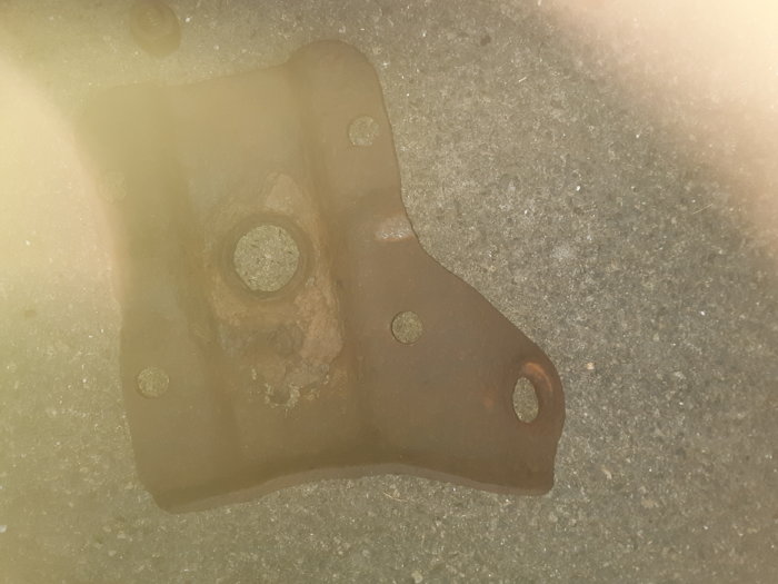

Does anybody have a good idea of where I can get some new center spring mounts?

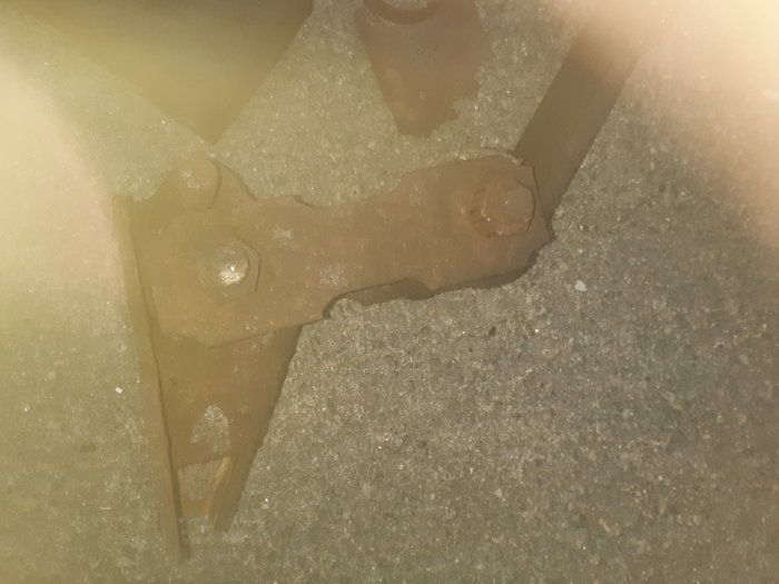

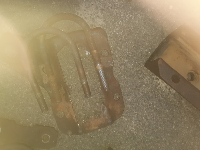

Thank you I just sent him an email. I did not expect everything to be this rusted out before the tear down my inexperience really showed on this on.

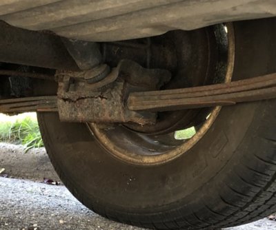

Go with an ISO Delete and use B body shock plates. Those are readily available on FABO/ FBBO. Mancini also sells them. This eliminates the rubber spring pads, giving a better ride and will raise the rear of your car around 1”.
Use B body shocks.
You can make a “washer” either welded to your axles perches or replace the bolt that holds the spring pack together using an appropriate sized washer with the correct (1 5/8” IIRC) outer diameter. I holesaw 3/16 plate steel to make them. I forget the outer dimensions.

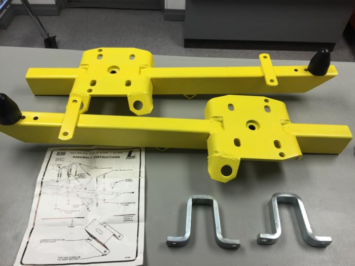

Or spend some coin on this, Firmfeel Mopar Suspension and Steering

$20 used traction bars at a local swap meet and $20 egag shocks.....
Read the above posts.......

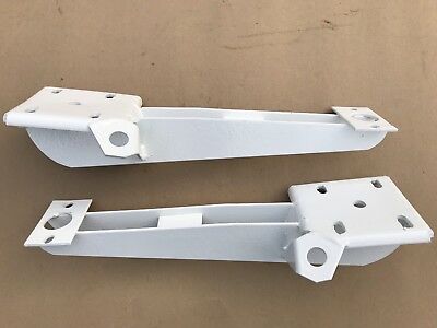

Generic internet pic. Sorry!! Lol
The OP can find these at at swap meet for $20 and not have to change his shocks saving him $20...
Total investment $20....

Top pic, drink beer, trim traction bar to use shock plate with a B Body shock.
bottom pic, drink more beer, trim traction bar and use stock shocks. Saving money on shocks to buy more beer.

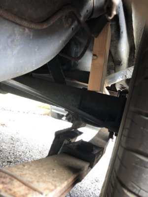

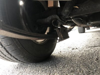

I was down and out dragging my leaf spring on the pavement to repaired in under $50.....
using a swap meet special traction bar, cut up to only use the “shock plate” from it.
I’ll add a pic when I get home from work.... CoronaVirus pending....
Sharp eyed viewers will know the wood 2X4 trick........

Thanks for the help Mirada you're giving me alot to work with. I dont have much imagination when it comes to fraburcating (big reason why I joined this forum) this is giving some things to really look into, see if I can get this baby one the road again. Btw that 2x4 trick is like some shit I used to see in my hometown all the time really gave me a laugh to seeing those pics.
1,494
Those ISO-clamp brackets (upper or lower) is an FMJ weak link.
The lower half comes in either 4-leaf or 5-leaf spring versions - which will not interchange.
My opinion, get some non-rusty replacements from Jim in Arizona or replace with a much stronger version (older A, B, C, E) body versions and toss those rubber biscuits to the trash can (where they belong). By doing that only, can raise the rear of car up by 1/2" and car will feel so much better over bumps and turns.
The downside is you will have to also convert to '66-72 B-body shocks and make a differential perch adapter (aka: a flat washer) to use the them.
The items MiradaMegaCab might also work - but you will still need to do something to make sure the differental perches are centered correctly.
