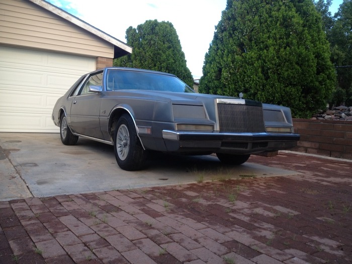

New Acquisition: 1983 Imperial
Made an attempt at starting today. Power on showed that the instrument cluster for the trip computer isn't functioning. Repaired some wires near the relay next to the power booster, power and a ground on the passenger side firewall. When trying to crank over there's, there's no heavy draw power, but it sounds like the bendix in the starter is sticking or there is possibly a bad wire to the starter. The engine did not even try to rotate.
If its a 'light' click i would say its still a bad connection somewhere, If its a heavier more substantial click, could be starter motor itself locked, or the engine is locked/froze. As mentioned I would pull all the plugs and use some sort of lube in cylinders, can be lube of choice and just let it set... (My cleveland motor had sat several years and had done the same... filled the cylinders with atf until it ran out of each. 4-5 days later bumped on starter a couple of times and had an instant oily mess, but I was happy. spun it for 30-45 sec. stuck plugs back in and fired it off)
That was 5-6 years ago, and it will start everytime with no ill effects..

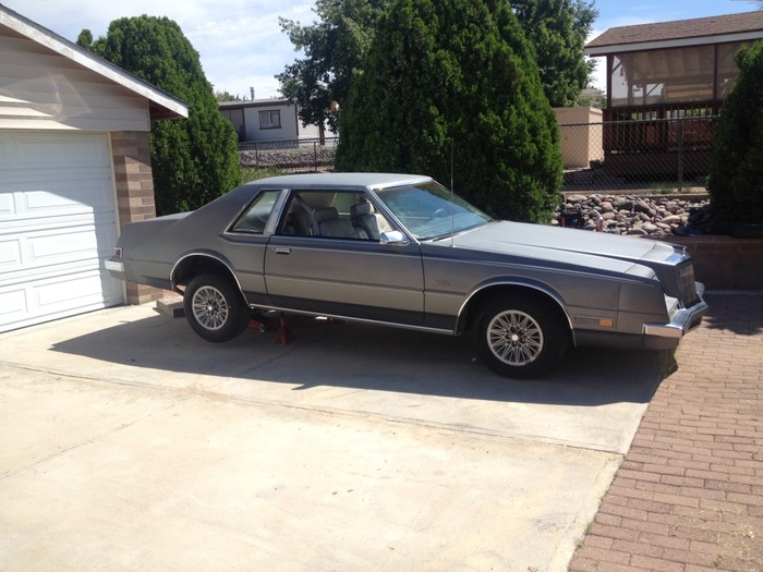

Tried again, fresh battery, same response. Jacked up passenger side, found a dangling, chewed ground. Can't get under the car at its current spot. This now starts the hiatus of the Imperial until I return in September.

Got it home today. Cleaned off the rodent detrius from the engine bay, attempted starting. Nothing. Rechecked wiring, couple of small repairs, nothing. Swapped out the starter relay from my Mirada, nothing. Replaced starter (NASTY.) nothing. Noticed hanging wires on passenger side undercarriage. A foot of wiring from the neutral safety switch had been severed. Repaired, engine turned right over, but no fire. Checked throttle body, blades were varnished shut. Some heavy chemicals later, the blades moved like new. Tried to start it, a quick choke, then nothing. Roped a friend in, blasted chemicals into throttle body, car ran for two minutes on that before we stopped.
Current situation: In-tank pump is certainly dead, and 20-to-1 the inline filters are carmelized with bad fuel. But she spun over, and ran fine...on Brake-kleen.
Notable issue: after repair, when key is on, the shift indicator shows both P and R as selected and the reverse lights are on. Ideas?
