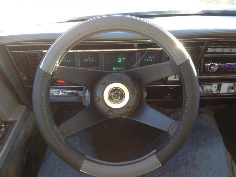

First award, Best Chrysler at a local show. And the new wheels are on it, 16x8 American Racing Novas. I can't get a good pic of the new interior to save my life, but that's done too, as well as new audio gear.

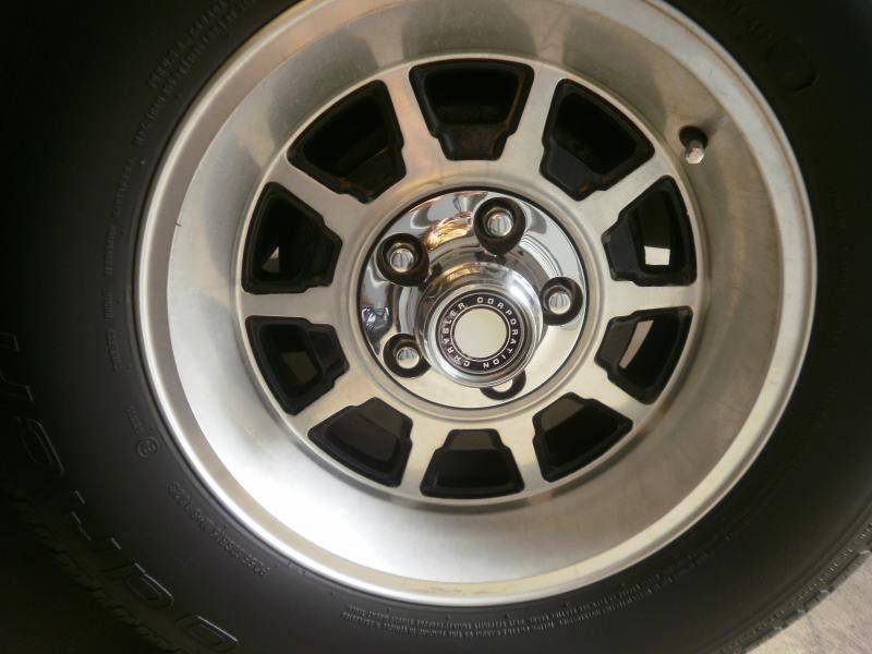

Lots of work done. Found out that a Chrysler LA PCV valve in a hole meant for a SBC PCV valve will vacuum up all the damn oil out of the engine. Driver's power window now functions. Put over 600 miles between Phoenix, Prescott, and Jerome, AZ. And my new piece...one I've been trying to find for almost ten years...

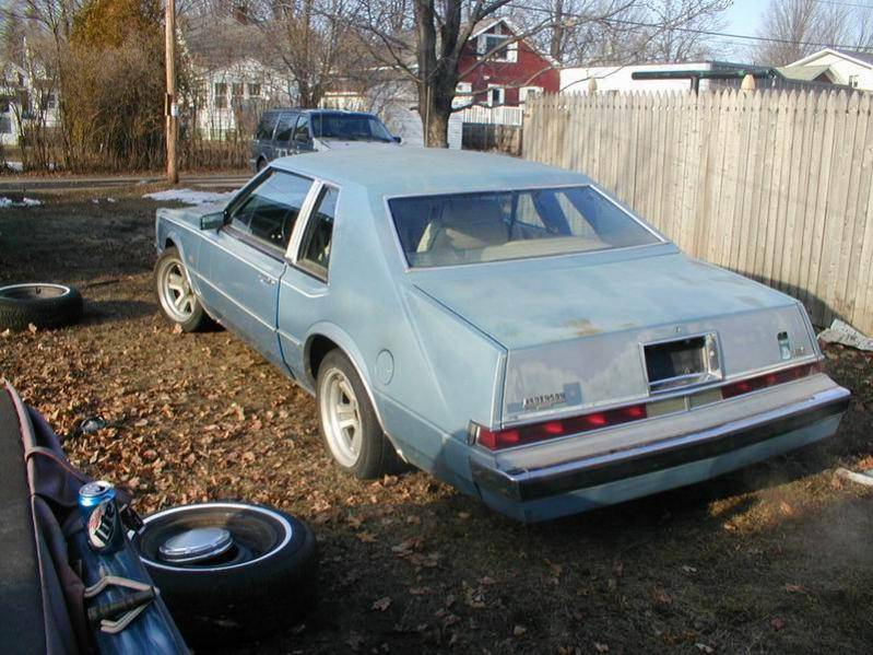

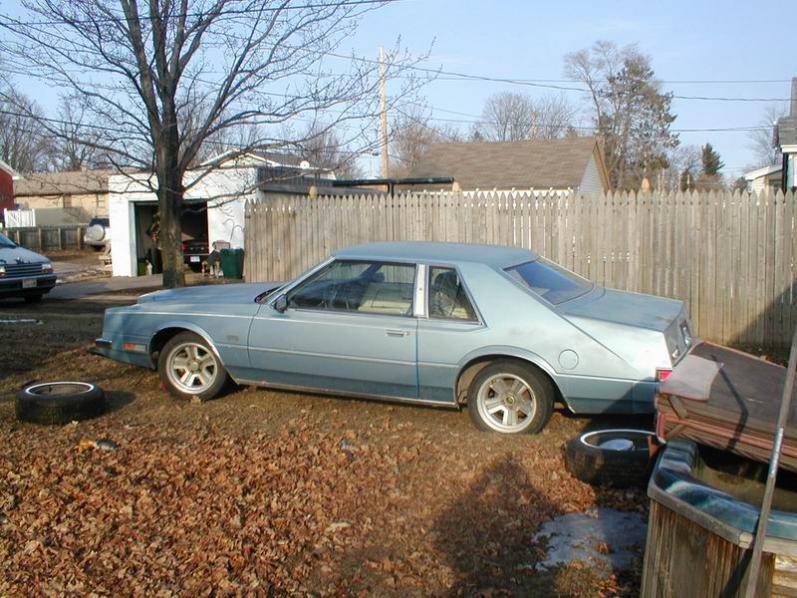

Here's a couple of pics of an '82 Imperial with the 16x7 and 16x8 standard TSI wheels mocked up:
Yeah, those wheels look great. You could use a spacer/bushing if you wanted to go back to original. Love those wheels with a little taller tire.
The tires I have for the 9" rears are 255/55R16s (27" tall) and no longer available. The ones in the photo are 225/50s (24.8" tall) on the 8" wheels. I sold the 7" front wheels to a friend.
I don't know if you could make a bushing that thin to go back to stock. The center registers are so freakin' close that very little needs to be removed to make the wheels fit. I'd just rather take the material off steel parts than cast aluminum.
