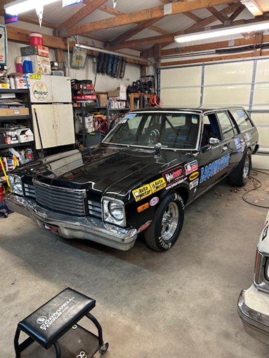

Bought Myron's wagon from him.
Originally I was going to bracket race it.
I decided to put my Son's wife behind the wheel & run it in Stock Eliminator.
Should be a fun season this year.
Finally got to make a pass in front of my house today, I'm digging it!
Let us know if we can ever be of any Help.
We have raced Aspens for 20 years in Stock and Superstock
and still run several.
GTX JOHN
Apr 8, 2012
71
28
Run the small cam 360 as it is quite a bit
lower HP rated and my stocker cams are not
showing much difference in HP with the additional lift.
The big cam just got a bunch of extra HP put on it by NHRA
a few weeks ago!
We ran our Wagon in I/SA as it did not like to carry the
weight required to run J/SA. It ran as fast as 11.30s prior
to getting factored from 270 to 289HP. Our Wagon weighs
3280 wet without my fat butt in it and has no special weight reduction done
to it.
As long as you can run the index and a little under you will be OK as
very few Heads Up races in the lower classes.
