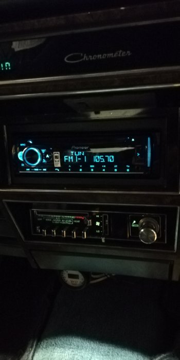

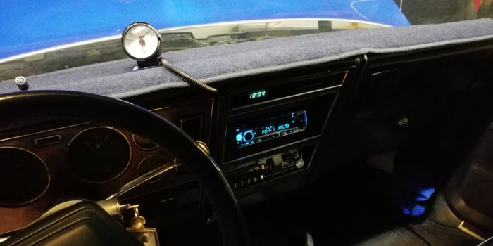

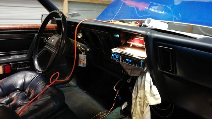

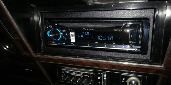

Hi guys,
I started talking about this is another post so decided to break it out on its own.
As you are aware electronics gets old, caps dry out and we'll you can repair and rebuild but things got better, receivers more sensitive, cd players, more watts, speakers moved on in car audio.
I couldn't find the right fit for my car but I think got something pretty nice.

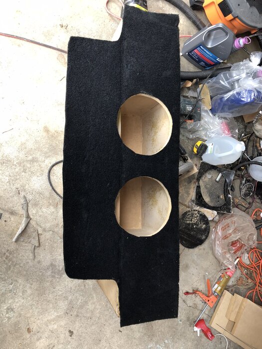

I choose pioneer for my system, CD head unit, 6x9" in the back, 6.5" in dash and 12" sub in trunk.

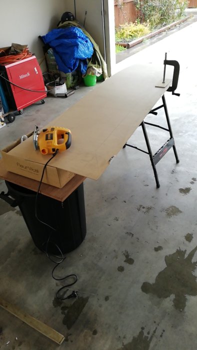

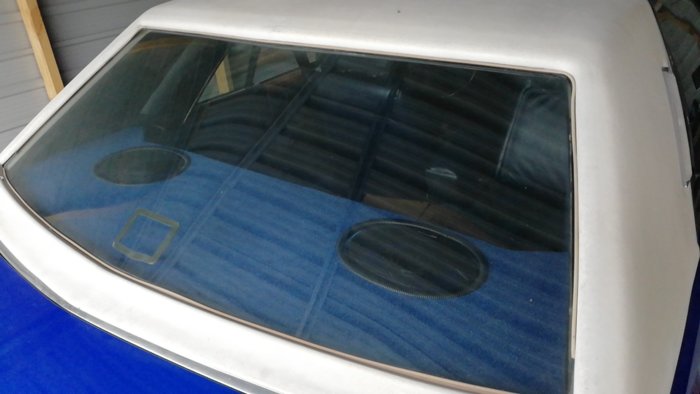

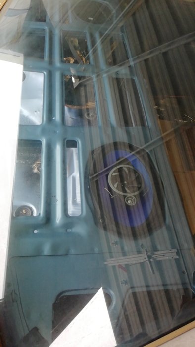

I made a new back parcel tray.
Trey

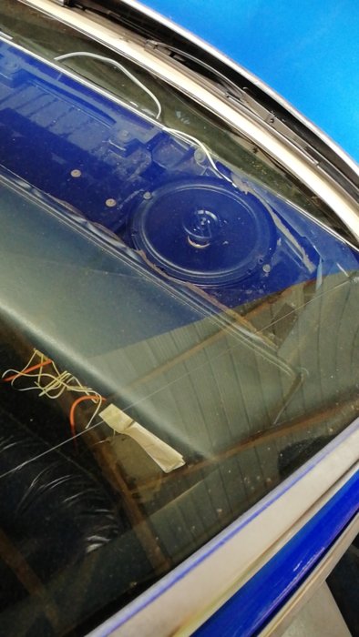

Looks good Bruce. Right now I'm doing the same thing to my Doba, I've even got the same head unit. I used Pioneer 6x9 tri axials in the back deck but my package tray was in pristine shape so I mounted the speakers under the tray so I didn't cut the carpet and it can be returned to stock if needed. Doing this killed some of the higher frequencies because of the carpet covering the tweeters. I want to replace the dash speakers like you did to hopefully get a brighter sound. What is involved getting the top plate off the dash? I looked and didn't see an easy way but maybe I'm missing something. Thanks for any help.

Top plate is clipped on, you just need to gently ply up and it will start to pop off, no screws or bolts.
Yes I made new tray and carpeted it, cut holes to let sound out.
I am very happy with the results, 6.5" is a bit of a squeeze up front, I would look at something smaller, but the 6.5" came in the package deal for the stereo so I managed to just get them in!

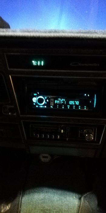

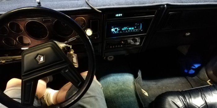

Looks like a nice clean install. I have a 30+ year old Pioneer cassette deck in my Mirada that I put in back in the day. (Still have the stereo AM/FM it came with, wonder if it still works? I even have the AM/FM that came from my 1970 RR that I had crushed in 1980! Wonder if that is worth anything, though it has been on the shelf for 39 years, wonder if it still works?) Top of the line, a Supertuner 3, remember those? I really should upgrade, maybe to something digital that would take an SD card like my other cars, but right now I am having what I think are ground problems for my antenna and I do not want to upgrade until that gets figured out. After my fresh repaint last fall I got crummy radio reception. Took off the inner fender well and ground a little but that made little difference. What I do now is use a cheap Bluetooth FM transmitter connected to the 3000 songs in my phone. There is enough reception for that but would like to have some radio now and then. Any ideas guys?

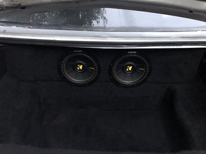

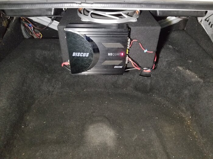

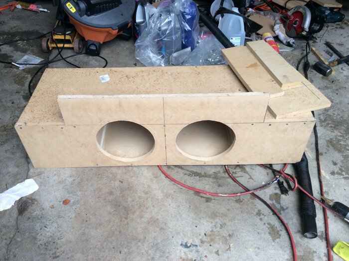

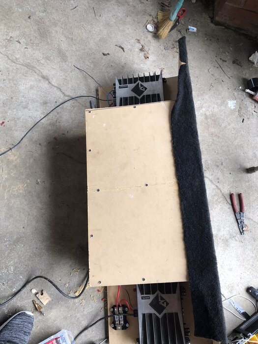

Running a pioneer head unit DEH9400BH with two Rockford Fosgate 200 A4 amps. Memphis Audio 5&1/4 in the doors and 6x9s in the rear and two 10” Kicker subs in a custom made box. I am running magnum accessories so I have a 140 amp alternator

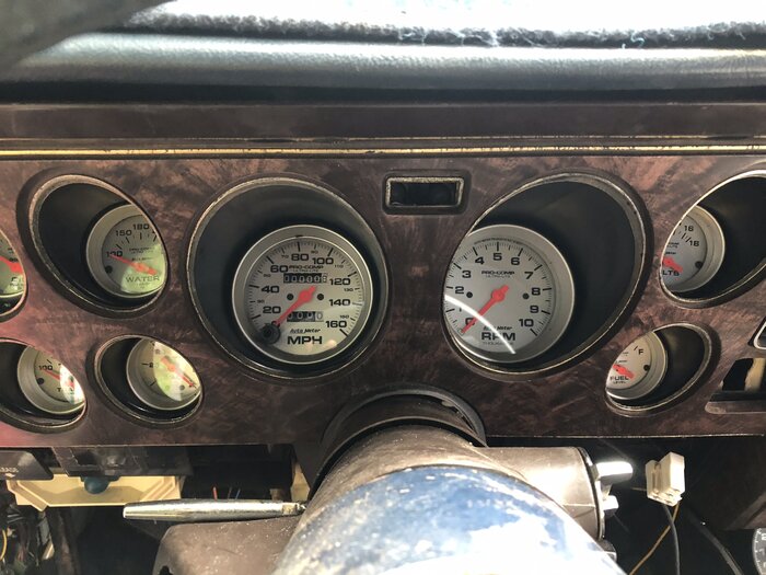

Also, nice work on the dash gauges! Make any notes of what was (gauges) used and/or pictures of that install?

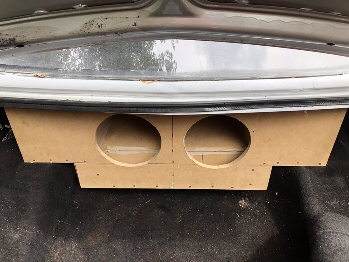

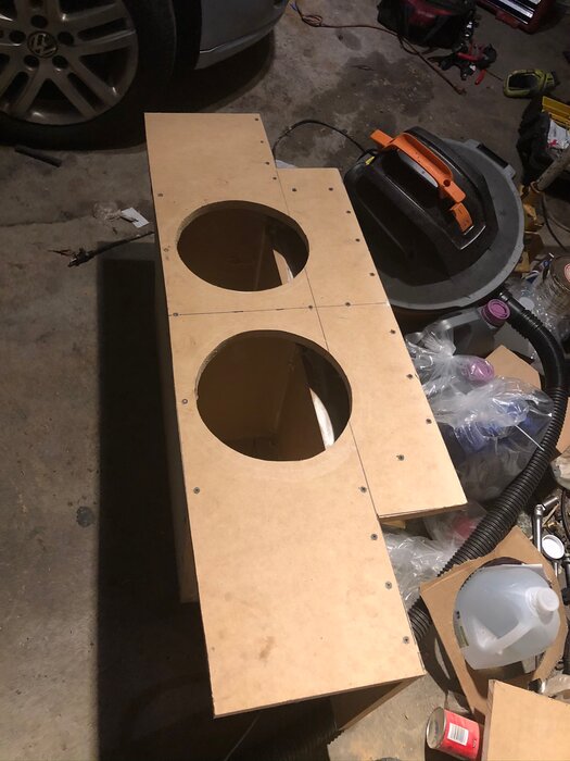

@Slodoba Got any photos of the sub box construction? I've got similar setup with a single 12" facing upwards, but I'm thinking of going to dual 10" like yours.

duke 5A:
If you are going to build a new box anyway, just build it for 2 12", using the existing 12" as one of the two. Save a bit of money, and much better bass.

Not room under the package tray to accommodate 12" subs. At least from what I measured.
This is what the setup looks like currently.

The two 10”s are loud as hell! My old Cordoba had 1 15” two 12”s and 2 6x9s in the rear deck and the new box is louder.
1,833
1,040
I really like that! Think I might have found myself a little winter project.
Those are just 10" Kicker subs, right? Amazon has them going to $75 each.
