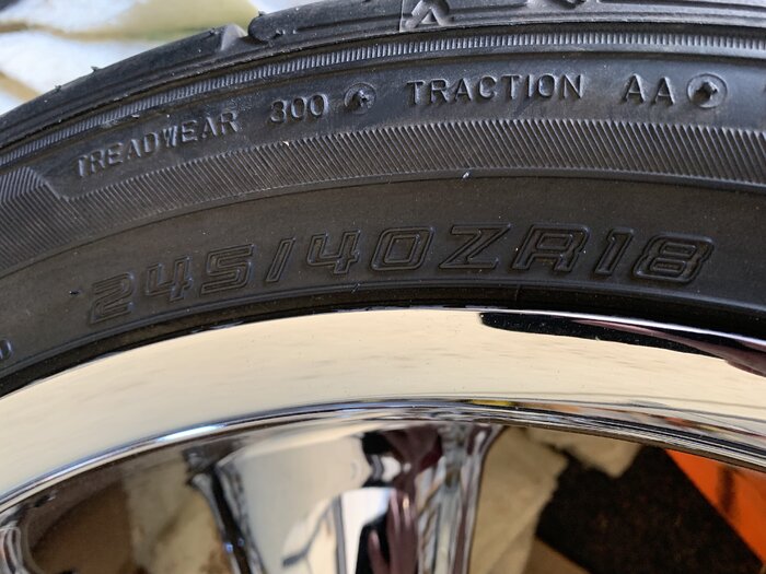

Did you notice your front sidewall is a tad shorter than your rears even though they're the same 40 series? Looks like about a 1/4" difference between the top of the numbers and the line above them. So maybe a 1/2" difference in overall height?
droptop
Jan 12, 2012
289
148
Yes. The aspect ratio of 40% increases the sidewall as the width increases. I like the small amount of rake this gives to the stance of the car.
