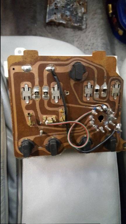

I have just spent a few hours soldering the PCB's behind the dash clocks as they were falling apart, and made a load of things work that previously didn't. A promising start!

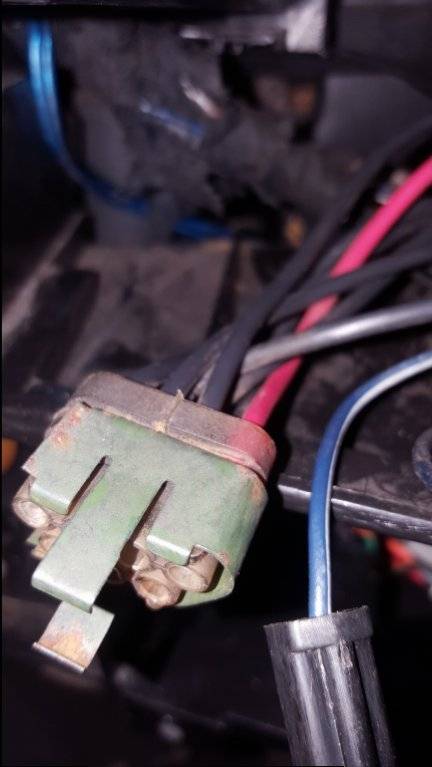

However! The rear defrost switch i can't seem to make latch on, unsure if the relay unit is tired or it hasn't got the correct load on it. The original stereo is absolutely wrecked and the potentiometer on the heat control is also bad. Does anybody happen to have any of these parts available for sale, or know any hints, tips or sources?

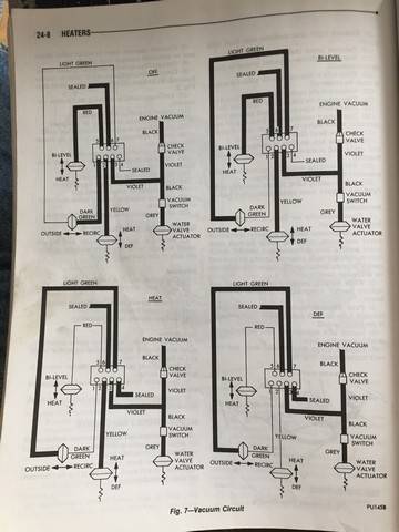

Finally, I really need to lay my hands on some wiring diagrams and also a diagram for the AC vacuum system as someone has cut half the lines.

On the vacuum hoses, a 7 port connector has a tendency to crumble (on some cars) after a few years. You can get some vacuum hose large enough to go over the existing colored hoses and can fix that problem.
I have seen 40 year old connectors that look brand new and others that look like crumbled bread crumbs.
I’m not a betting guy – but I would bet that you have both the crumbled vacuum connector as well as a bad servo.

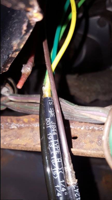

Right, so, having a play this afternoon. The vacuum lines on this car do not match up to the diagram, at least in colour, i have one red and six black to the connector which seems in good order, i can spy a green and a violet behind the dash but no idea where they join up into things.. any ideas?

Ahhh. Right, in the past some previous owner has had crumbly connector disorder and has made bodge job of the year with sticky tape and some grossly oversize pipe. Now i understand!

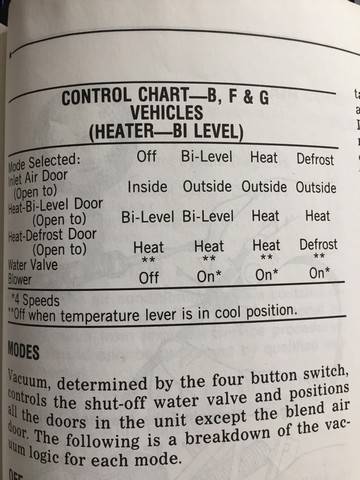

Well in the meantime i have the whole dash top out the car, and i got myself a workshop manual. The only thing i am struggling with now, the passenger side knee-pad under the glovebox, it is held to a rail under the bottom edge.. everything is rusty, are they rivets in there? If they are... WHY?? :)
