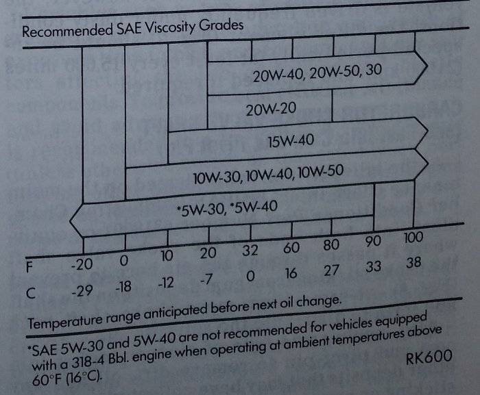

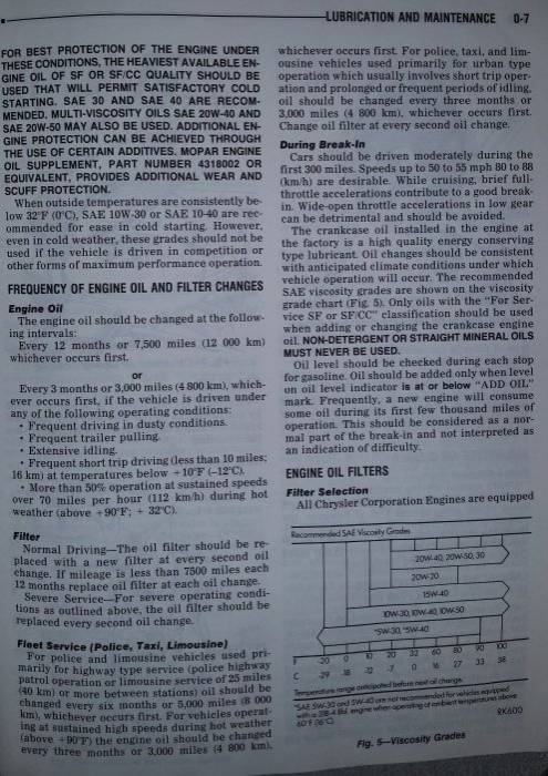

In town driving 28/29 PSI is good (makes pot holes not as harsh) then bump it up to 32/35 PSI before making a long trip, for better fuel mileage.
The engine holds 4 quarts (US) (or 3.34 Imperial Quarts or 3.78L)
Plus the oil filter.
From my ’86 FSM (which should read identical to the ’84 version).

Hmmm.... Maybe 10w40 instead. It's very rare for temperatures to get much below 25 or above 85 in my neck of the woods.
