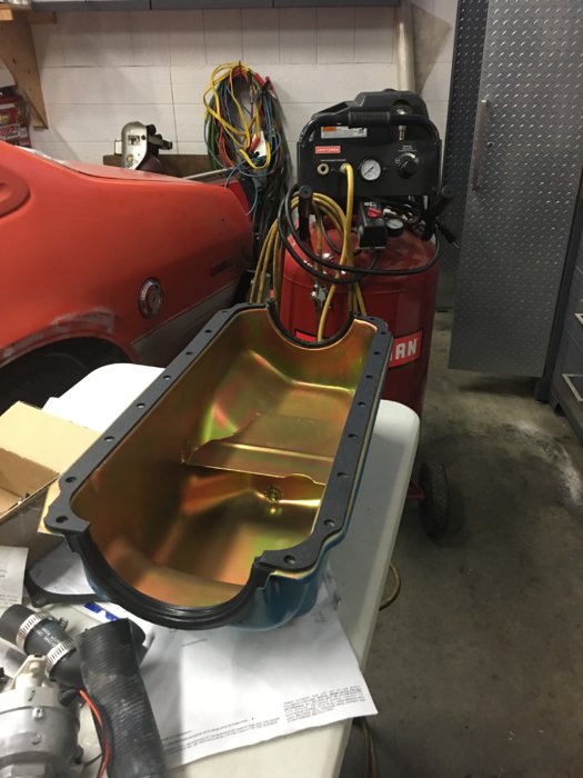

We used RTV ultra black and an impact..if it leaks, I'll swap engines so I can make sure it's on there better..haha
Get ready for leaks. NEVER use an impact reassembling an engine! You probably just deformed the shit out of the pan rails.

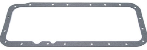

This is a typical big block oil pan gasket:
If you have an windage tray, then double that gasket (one for each side of the tray). Note: windage trays are free horsepower. I won't run a small or big block without one – even a 318 2-bbl.

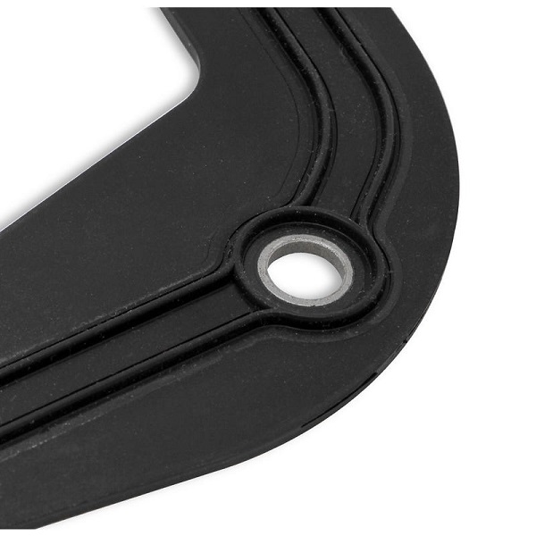

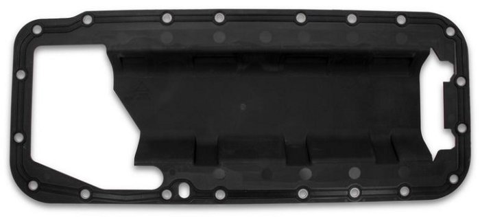

Mr Gasket came out with a wonderful oil pan gasket for big blocks not long ago:
It combines both oil pan gaskets and windage tray in one part. It also uses more modern gasket materials and bolt torque limiters which is a plus:
This, however, is not useful for those with a small block.

Impact wasnt first choice, but it was kind of a necessity considering the position (especially the front 2 bolts. We did get everything started then came back and torqued in order.
Needless to say, this will not be a job done in the car again. Hopefully, I won't need to do it again at all..but time will tell.
