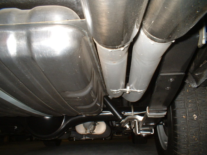

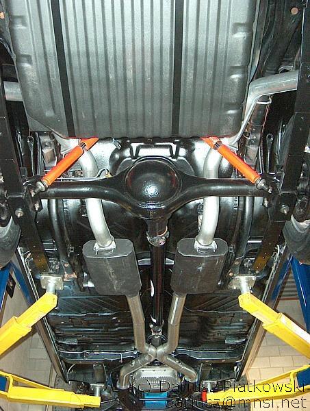

    Here is what I ended up doing on my coupe (slightly shorter wheelbase than your 4dr - by about 4" I think, all of it in the rear seat floor area).
    Oldiron440 likes this.

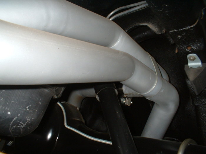

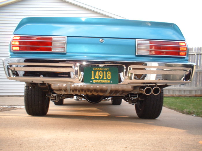

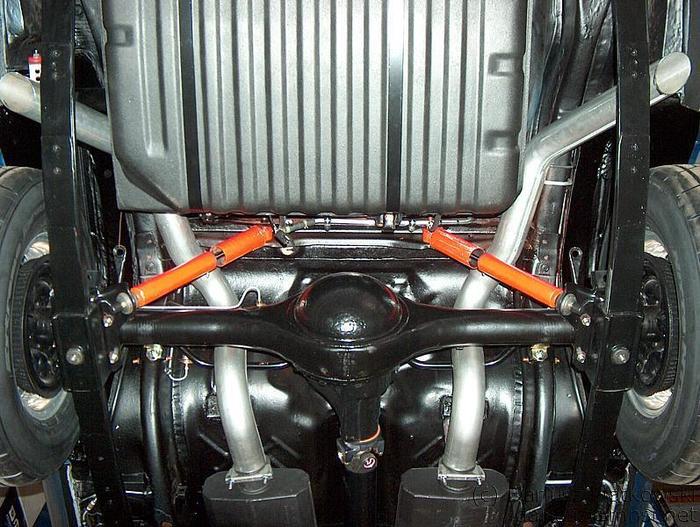

    I know it's hard to see in the pics but, I ran both t-pipes out the right side of the car by crossing over above the axle. Despite how it looks, they don't touch anything. DSCF0002.JPG DSCF0004.JPG

    To get the pipes out the rear bumper on both sides is a lot of grief indeed - these guys are totally correct. You need to move the gas tank over a strap and elongate the filler tube. If that were it then it would be easy, but the way the tanks are on these cars the middle top where the vent is has a bulge and the trunk floor is pocketed to make it fit. If you attempt to move it over that bulge in the tank contacts the floor. Only option is to beat the shit out of it with a hammer to make room. If I had it to do again I wouldn't have done it this way...too late now. How Aspen500 and M_Body_Coupe did it are the options you want to go.

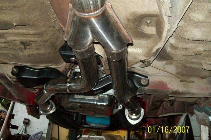

    I did 2.5" into Y and single 3" tail pipe. Simple and works great. Not as cool as 2 pipes, but works very well. 100_3759-jpg.jpg

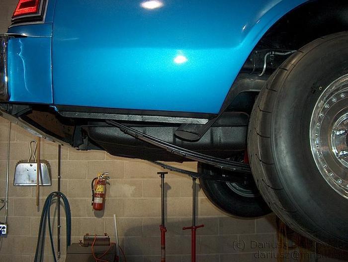

    Here's my 84. I used the A body Jegs dual exhaust kit. I moved my tank over one rib and extended my filler neck by 2" with a spare I had laying around. No problem with the tank not sitting right no hammering needed.

    I’m thinking about going the route Aspen500 went – but having pipes stacked instead of side by side – possibly – for my preference is rear exit. I’m not to that point on my project – so this “tin can” is being kicked around, still.

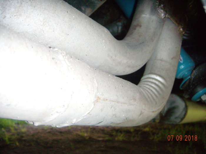

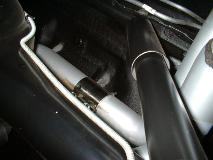

    Our J has the routing described by Aspen 500 but it's just two stock 18 dollar tailpipes welded together. It was an afterthought because the Flowmaster 40s' dumped straight out forward of the axel. On acceleration the noise was too loud. You could hear the secondaries kick in.
    So this was to get the noise down and the heat scavenged elsewhere. The mufflers are too far rearward. So this would be critical in planning a new install.
    There is very little tolerance in placing the stacked pipes over the axel. Ours clunk occaisionally against the frame. And after removing the air shocks there is a rub against the passenger shock when encountering large heaves in the roadway. So that's what we've found with the stacked pipes. Possibly some points to consider.

    I like jasperjacko's install. Fully functional and much easier. I think that's what we will go with next time.
