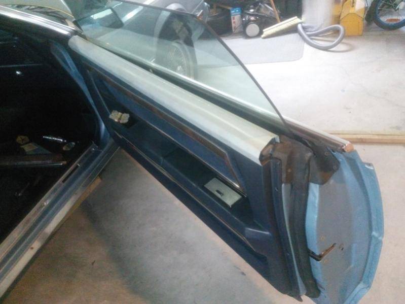

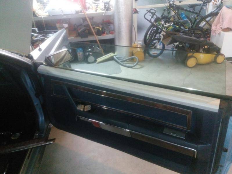

Ok guys, I finally got around to taking my cracked door moldings off my Cordoba, I have taken them to a shop and I will be getting them drawn up and a machine will fold up some new ones. I will keep you posted with the results, how many other people would be interested in some nice new folded top door moldings? I still have to work out what I will do for the internal weather strip.
I'd be interested, as well. Brad's has NOS Featherwoods for about $500, and he has a set of blue ones for about $400. If that is the "going rate," I'd pay $200 for a repo-set of blue ones.. BUT -- They'd have to look NOS, and have the weather strip.
In my case it doesn't matter if they look factory or not since my car is custom, but I know that may be a consideration for some. Now I'm recovering mine with vinyl, but otherwise may fold some steel to make some but dont have access to a large enough brake right now. Only one I have is 18".
Ok for starters these will not be NOS, they are going to be made out of zintec, they can be painted or have a 3M wood grain stuck on, they are quite complex to make, if this all works out they will mount slightly different to keep the cost down. My aim is to tidy the inside of the car up, I think if you want stock you can buy the same ones and the first time you close the door they will be cracked again. Least mine won't looked cracked anymore it detracts from the interior of the car with big cracks around the door look. The weather strip is likely to be a piece of metal with some mouse hair on it. I will post photos as things progress and people can deicide if they want any and are happy to pay freight from NZ to USA.
