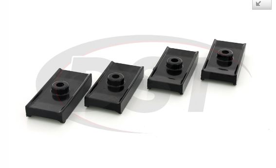

That said, I do recommend to either toss the Iso-Clamp system and use the older shock plates OR replace the rubber biscuits with polyurethane ones.
http://www.energysuspensionparts.com/5.6106
Note: this is one source of these pads – there are others out there as well.
Note: I recommend using the older style shock plate – but many here have used the poly pads (above) without any issues.
Either version will make car handle much better
