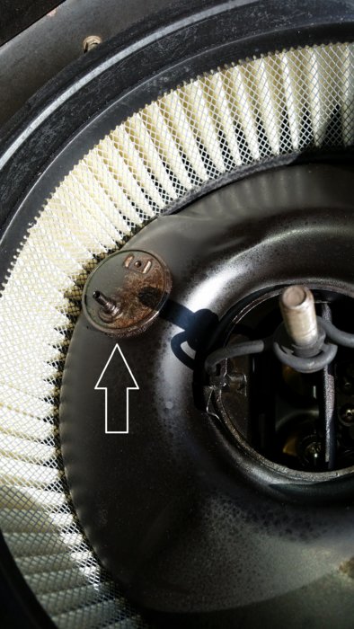

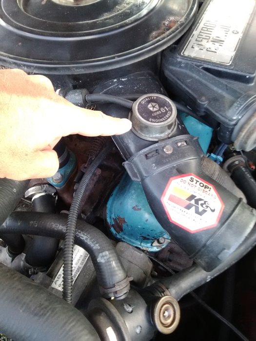

    What's the name of this part (it needs to be replaced) IMG_20190221_142027.jpg

    I don`t think that part is sold separately. Arizona parts shows a used housing for sale
    4227092 AIR CLEANER BODY,PU 4306361 SOP S SIDE OF A2 1985 M BODY 1 ATAA 35

    I have heard of them being called Air Cleaner Vacuum pod or Hot air actuator but I don`t know the name listed in the mopar parts book.

    That would be a vacuum motor.

    It's hooked up to a temperature controlled vacuum switch. When the car is cold engine vacuum will pull the trap door shut and pull in hot air from the flexible metal hose underneath that runs to the exhaust manifold. When the car heats up the vacuum goes away and the trap door opens to let cool air from the outside into the air cleaner.

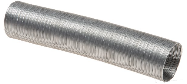

    That silver expanding aluminum hose ... I have a replacement one I need to put on my car.
    Thanks for the info.

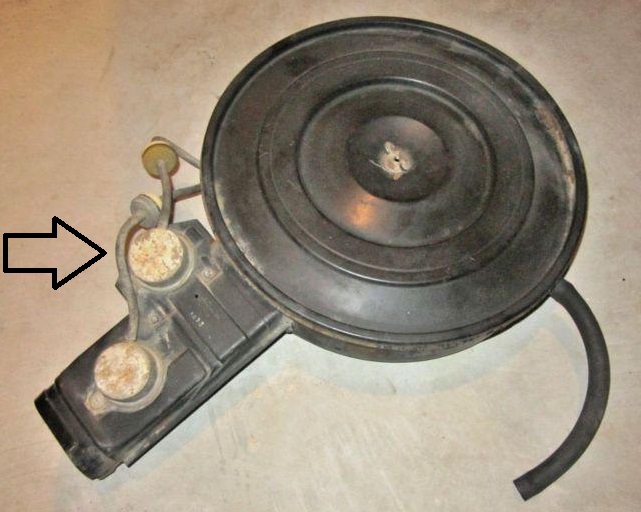

    MoparDan, basically all that has been said is true. That is a vacuum motor that allows hot air entry from the exhaust manifold heater. It allow for better cold weather drivability for those colder areas (up North).
    Sense you live in an area where freezing cold weather is not an issue, you can disconnect that entire circuit (put a rubber plug on the carburetor nipple). The black (or silver) corrugated hose (2 inch / 5 cm diameter) can be removed. By default, the vacuum motor only opens when it is cold, so being disconnected will not affect anything – where you are at (in sunny Florida).
    Up North, it is a “must have” item.
    Where I live at, Oklahoma City, OK, we do get both extremes. Last February, our average temperature was below freezing (I think the avg was 29’ F / -2’ C). In August, it can get well above 110’ F (43’ C). Yesterday, we had 80 MPH (130 kph) winds to tend to. In about 2 months, it will be officially tornado season here.
    To be honest, I don’t see a lot of those vacuum motors fail. I might even have a spare in my garage – if a person really wanted to replace it. Pretty much all of Chryslers air cleaner vacuum motors will work for a replacement (if it looks similar – then it might fit and work fine) – but there are a couple of differences over the years.

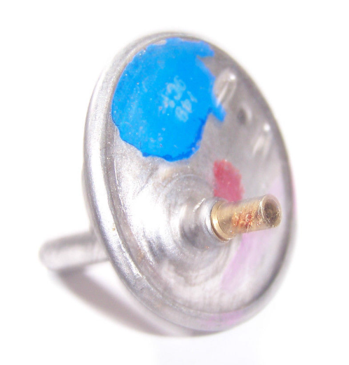

    There is a temperature switch that turns on that vacuum motor, that is located inside of the air cleaner. The hose from carburetor goes to the temp switch first, then goes to the vacuum motor on air cleaner.
    On an unrelated note: there are different temperature ratings for the switch, and different paint stripes indicate the temp switches on at. I think Chrysler used about 5 different temp ratings on those switches (but not sure why).
    Blue / Red for this one.

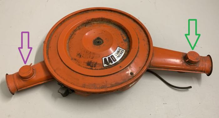

    Dual snorkel air cleaners use a similar vacuum motor for other side (second snorkel) but it only opens when engine vacuum is low – to reduce engine noise (open only during WOT (Wide Open Throttle)).
    The greet arrow (temp door motor) is the same as the second door motor (purple arrow). The second door stays closed unless extra air is needed.
    Some mid/late ‘80’s 4-bbl M’s have a second vacuum motor on the side of air cleaner (black arrow, below). That motor closes off the snorkel when car is turned off, to keep fuel vapor inside air cleaner – to comply with fuel vapor emissions (on 4-bbl cars). I’m not sure why that wouldn’t also apply to 2-bbl cars – but I’ll avoid going down that road.

    JustWondering, the hose is sold by O’Reilly auto parts (and others) as an emission control duct.
    Gates # 28095, which is 2” inner diameter and 18” long (cut to fit). There are other manufacturers that sell it as well.
    The original Chrysler part is black. All the aftermarket ones I’ve seen are silver. Both works fine.

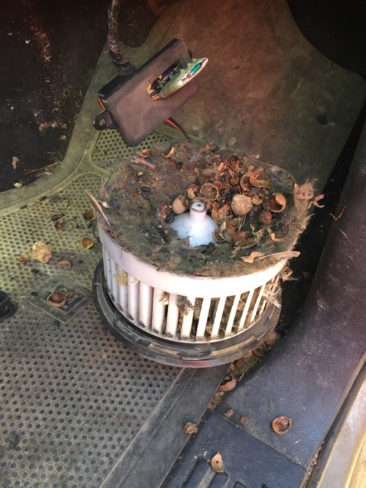

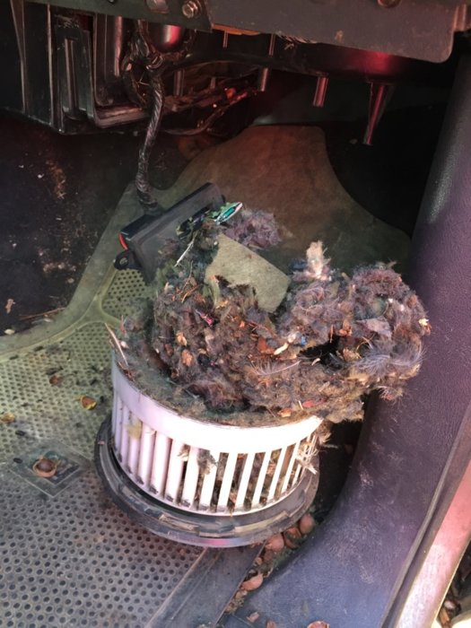

    My A/C wasn't working in the Silverado this weekend... just made some noise like something was in the blower cage. Then I turned it off and it sounded like something was scrambling around in it.
    So....
    I turned that sucker and and let it run for about a 1/2 mile.
    Turned it off the 2nd time and no more noise.
    The picture is what I found today when I took it all apart to look.
    I'm in the market for a replacement resistor now as only 2 of the 5 speeds work
    and two new cabin filters.
    JW
