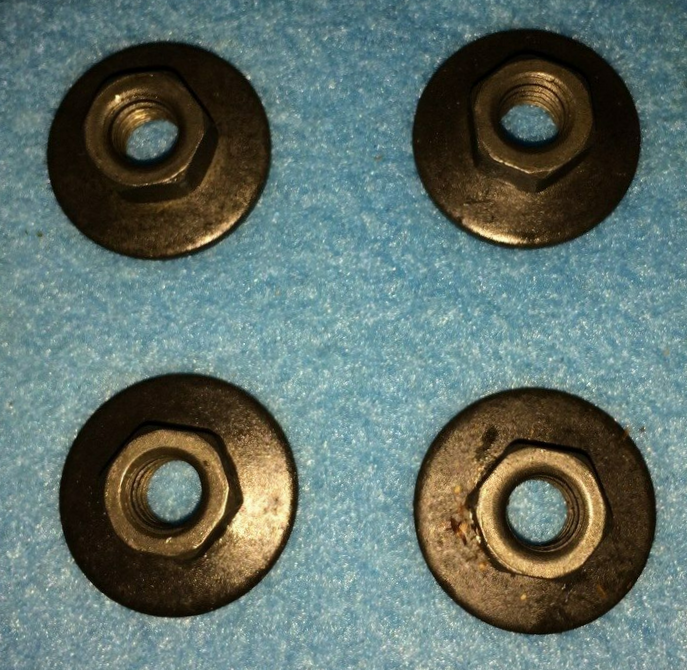

Remove the seat from car (or at least unbolt it from underneath the car), pull up and can do changeover with seat inside of car (but is easier with seat outside of car - but also a bear to man-handle solo). There are four captured nuts to remove, one or two of which might be behind the exhaust heat shield. The nut size is 1/2 inch (I think) and you will need a deep socket.

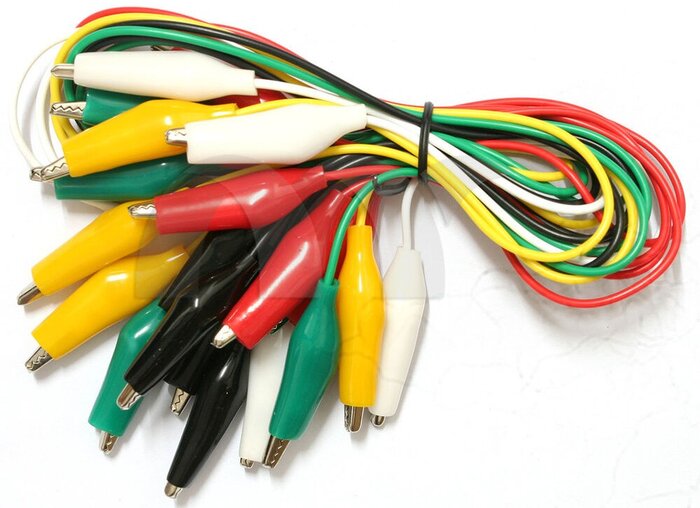

It is also good to get out a wiring diagram and test the power seat operation before installing - which can be done with a few jumper wires.

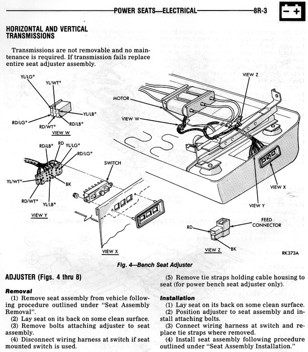

Below is a PDF file from my '87 (Front Wheel Drive) FSM - which is similar, but with a few differences.
