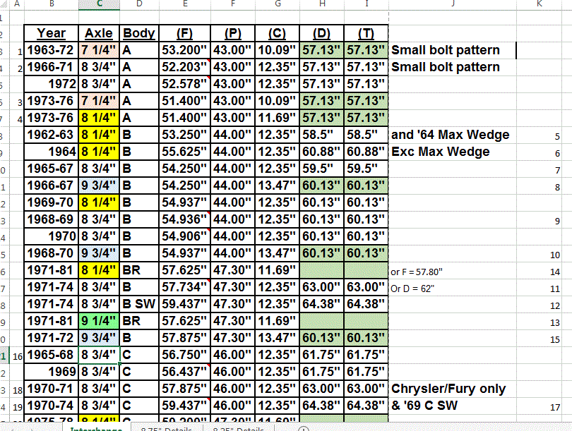

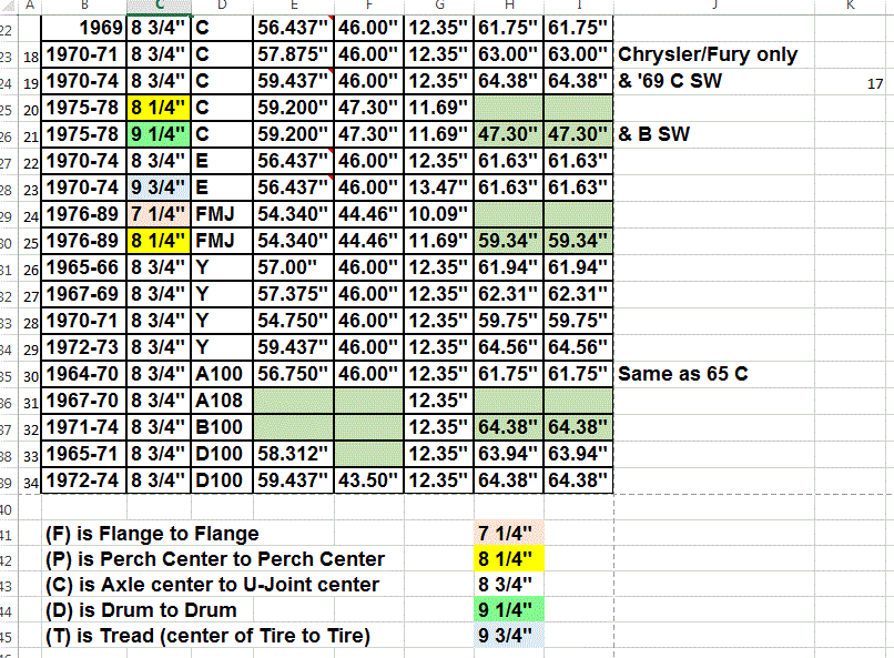

In addition to the part manuals, I have a bunch of other files, like bell housing part numbers and other items in an Excel format (data taken from internet, corrected and then added upon).
Attached are pictures of a differential Excel file I’m working on. Some details is not known (green background) – but this is more accurate than other files found in the internet. This sheet is still work in process and I have a bunch of other files like this one.
Compare my pictures (below) to this page Rear Axles: Mopar Rear Axle Dimensions and Identification: 1962 to 1989 (for example).
Note: I made the above file for me, and will need more formatting to make it clearer for others (a work in progress).

I made a screen shot (windows snipping tool, actually) from my Excel spreadsheet that I made.
There is a sheet similar to the one above that is incorrect, commonly found on the internet.
I’ve done a ton of research on many aspects on these (and other year) cars. Most are correct and some is way incorrect. The differential measurements are one example.
In the above case, I am looking for two differentials of the ’66-67 B-body vintage, for they are the closest match to F & M-body cars (part of my performance upgrades), in my opinion.
Others prefer the wider track (Chrysler calls tread) of the ’68-70 B-body’s (which are 0.687” (11/16”) wider.
Some say they are the same (NOT).
I have been in more than one heated debate with people because they believe what the internet says – which says ‘66 through ’70 B-body all use the same differential housing - and they do not. Again, it comes back to believing what they see on the internet and not researching it themselves.
