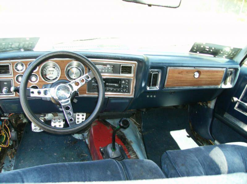

The A & F-body cars have the shorter tailshaft needed for the swap, but if you can get it with the shift linkage in place, or make sure the seller knows what he's got when you're shopping. A-bodies were available with both close-ratio and OD transmissions in '75-'76; all F-cars were OD. Simply put, the close-ratio 3-4 linkage rod from an A-body will not work without modification on an A/F-body OD transmission and vice-versa. The other linkage rods can be made to work. Replace the crappy Inland shifter used on OD transmissions with a Hurst Competition Plus piece from just about any Mopar application. Optimally, you'd get your hands on a set of rare Hurst Comp Plus rods for the overdrive transmission... but don't hold your breath.
