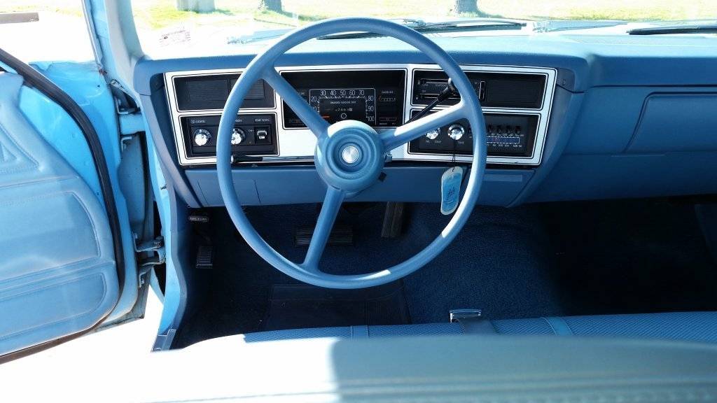

About two months ago, I put my cell phone charger in the lighter to charge phone on my trip, but nothing. Note: this was the day before a car show I was about to enter car into – so I didn’t have a lot of time to play with. Later that day, I removed the knee booster and both parts of ashtray to see what was up and at that time I didn’t see any lighter wiring – at all. I also noticed the ground strap to radio was missing – which was why the radio has been cutting out randomly when dash lights are on.
I just used an alligator clip jumper wire to fix radio – until I could find a ground strap for a permanent fix – but still found nothing for lighter wiring (either the red power wire (with the black elbow connector) or the female spade ground wire).
This is a picture of the dash (taken just before the car show).
The odd part is lighter element appears used and ashtray appears well used. I can see a well-used ashtray if someone used a regular lighter, but with a used lighter element – tells me someone did something to my baby (before I bought it).
I’ve sense located a radio ground strap – but waiting on temps to drop to a more reasonable number to work on it.
A good thing I don’t smoke, I guess.
This is a picture of dash, just before the car show.

The dash hasn’t been taken too far apart, yet.
I suspect the wires were cut sense the existing cigar lighter element appears used.
But
It could be the car came without a lighter from factory – then someone found a used one (with correct knob) and installed it incompletely. Who knows?

I am thinking that you may be onto something, believing that the ash tray, and lighter were added by a previous owner. I would be surprised to learn that such a stripper came from the factory with a lighter. I have encountered much more heavily optioned F's that had not factory lighter.

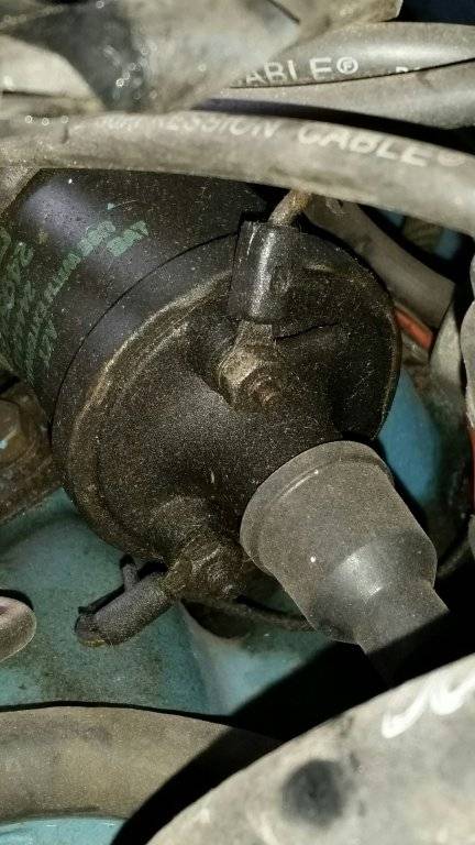

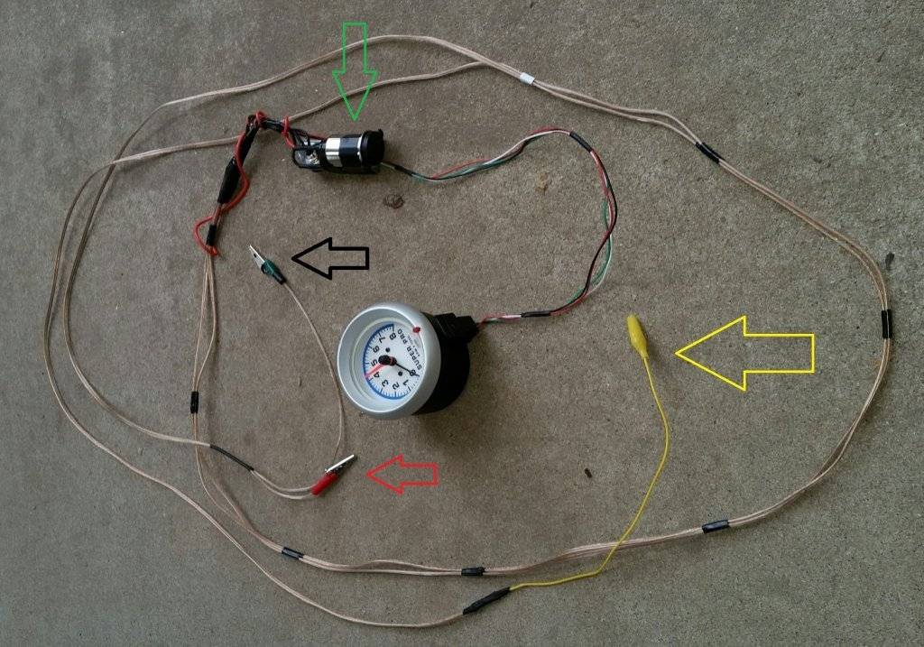

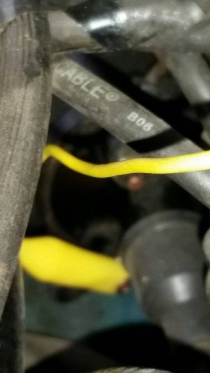

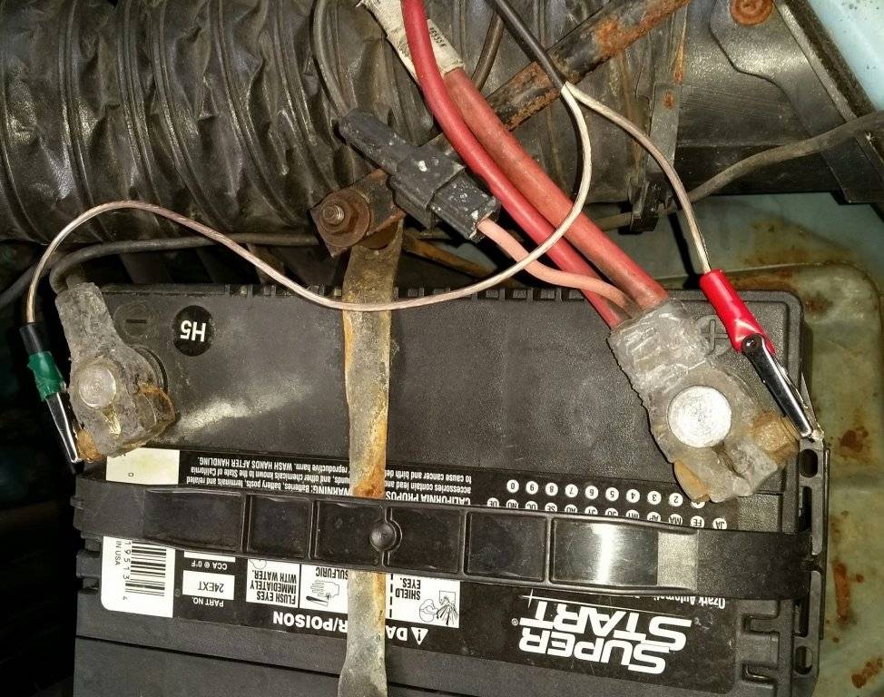

A picture of my tachometer and power supply I made for testing purposes.
For those wanting to know:
Red and Black arrows – battery

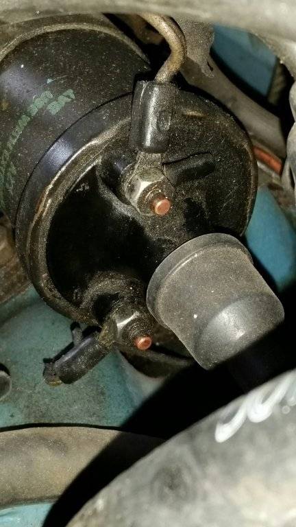

Yellow arrow – for yellow tracer wire (-) to ignition coil
Green arrow – a cigar lighter / 12 volt power supply to hook up my performance meter up to or whatever else needs a temporary 12 volt plugin.
All I can say is – it works.
The ignition coil needed a bit of cleaning to read.

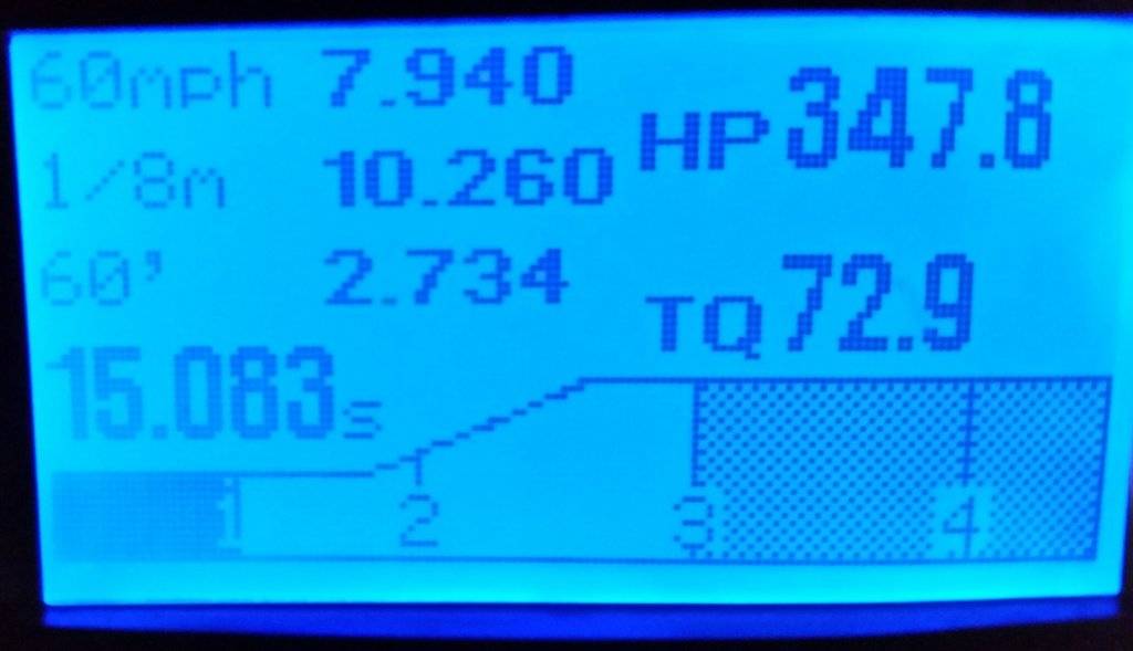

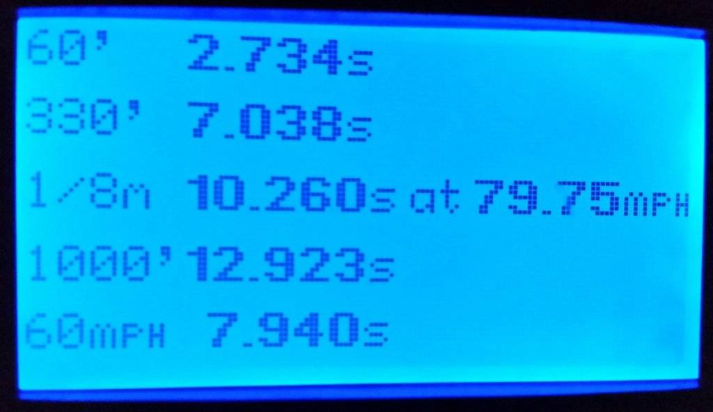

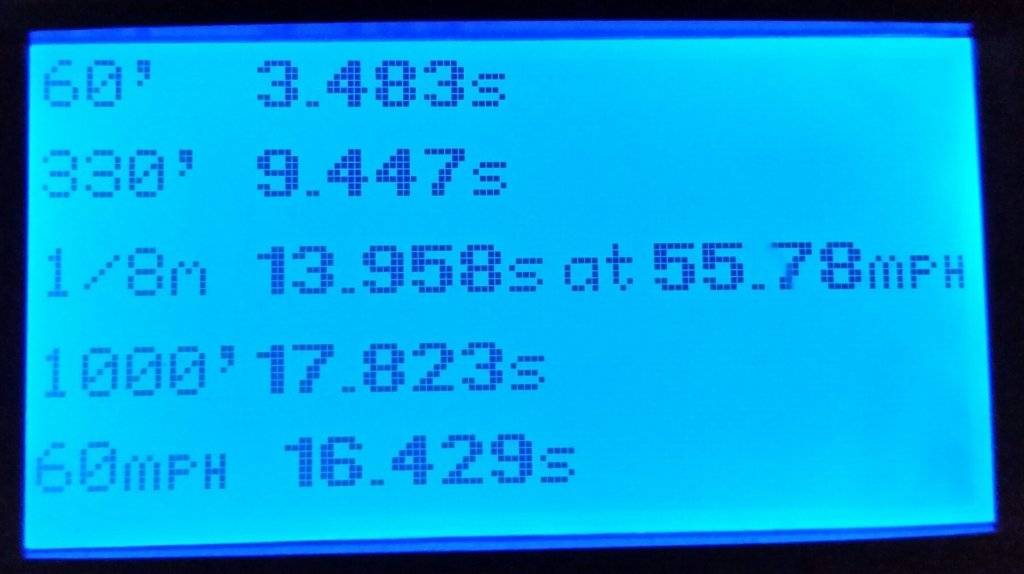

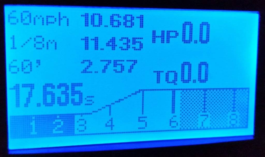

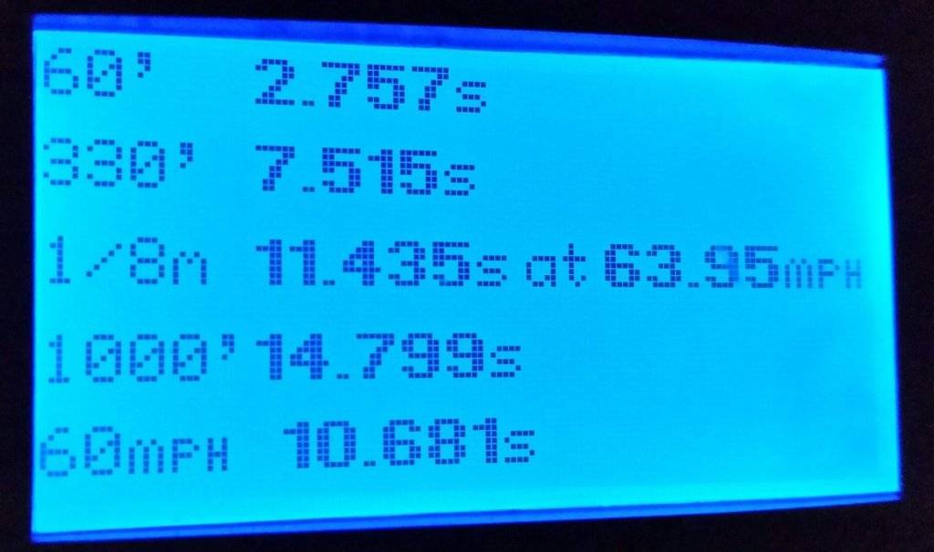

1,492

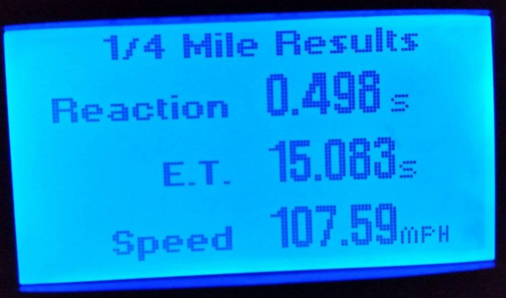

I finally read, and re-read the instructions and found out I was doing it wrong.
The above readings I deleted (were not correct).
These are from my (stock) ’86 5th Ave 318 2-bbl 2.2.
I’m not sure what is up with the HP or torque readings – but they are not important to me anyway.
Note: this is three of several pages it will display – but ones I thought were worth posting here.
1,492

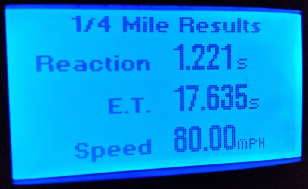

These are from my (stock) ’77 Volare wagon 318 2-bbl auto 3.2
The only difference between this and above car is vehicle weight (by how much IDK), Lean Burn (in 5th Ave) and gear ratio.
1,492

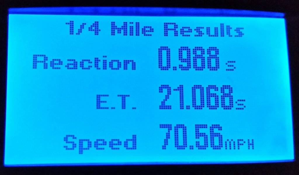

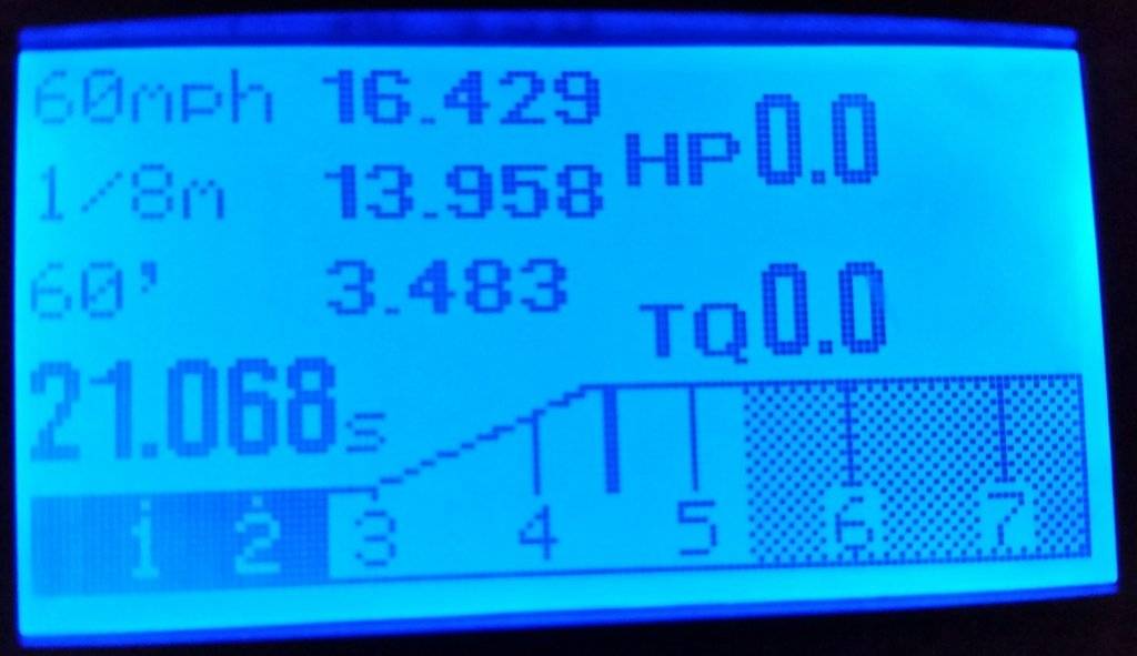

I got around to hooking my performance meter on to my ’97 Dodge diesel pickup (mentioned above) and here are its results. Remember this truck is pure stock with 230k miles on it.

1,492
I think the HP/Torque readings are haywire.
I was going to take a picture of that screen, but didn't and you will see what I mean.
The engine is rated 215 HP / 440 foot pounds of torque.

I was wondering about the weight issue as well, but I have a weight stamp ticket (before and after) from our city dump a couple of years back – so know about that one.
The weight readings I entered on the Station Wagon was 3600 pound (a guess) and 5th Ave was 4000 pound (also a guess) – and their HP/torque readings are way off, as well.
Will need to plug it back in and get pics to show.
The HP, torque and RPM readings are nice to know but not critical, as much as the other data is (for testing purposes).
