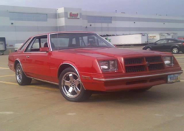

17x9 275 40 17 5 5/8 backspace. plenty of clearance. 18's would have been better, these tires were to short for my taste.
Jonnyuma
Nov 6, 2011
342
81
Well first, I think it looks great.
[QUOTE="jasperjacko, post: 84924, member: 399"... ]these tires were to short for my taste.[/QUOTE]I won't look at anything below a 45 aspect ratio for this car, and that's on an 18" rim... I'd prefer a 50 or 55 series. Ive found some wheels (17s and 18s) that I think are "Lebaron classy", not too sporty or "tuner"- looking for reasonable dough, but no matter what this is gonna be expensive
