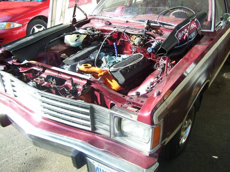

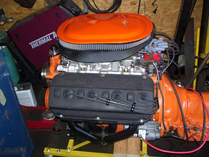

Oil pan I used was just a stock center sump oil pan. No modifications needed. Center sump pans can be a little tricky to find but they are out there.

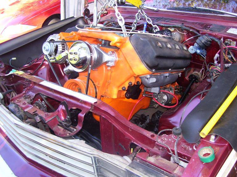

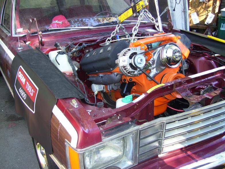

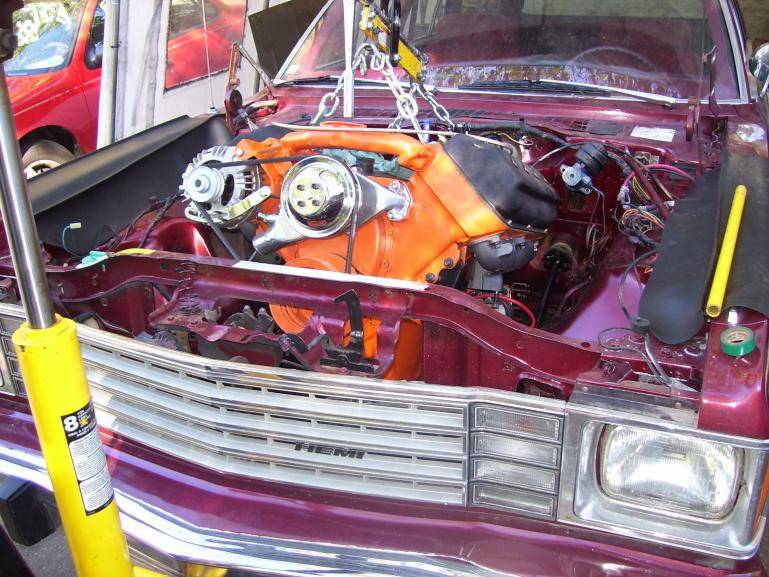

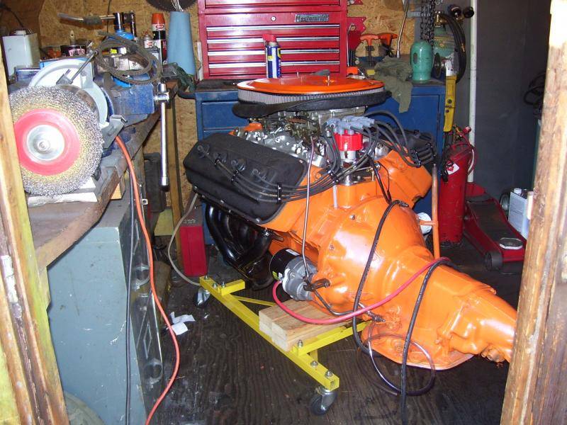

well got the hemi in and it was a pain in the butt but it will be worth it in the long run and you need to remove the heater to get it in
PS
and you dont need to replace the torsion bars i will have to back mine down to get the proper ride height

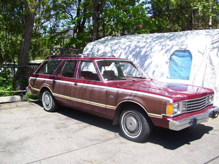

Absolutely beautifully insane!
A hemi wagon
Wow!
You absolutely have to send this build to Mopar Action.
They'd run it for sure.

That wagon is just nasty, your going to blow peoples doors and minds...
