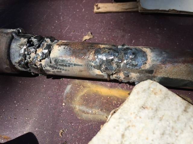

Oh my... I suck at welding round tubes back together.

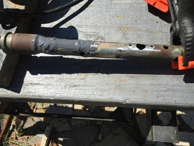

I do have the welding finished and will post pictures this evening. I decided to cop out and jbweld over the nasty mess I created.
My welding helmet is an auto-darkening and it no longer auto-darkens... Its just always dark. So I tried welding in the sun but I kept getting shadows and welding all over the place. lol It looked butt-ugly.

It will hold together now and the antenna guts will be returned to their proper glory soon.

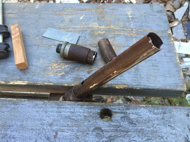

I cut up the tube trying to understand how the thing worked and what it was made of.
This was necessary for my education, but totally not necessary to fix the antenna. Brian - you are a good sport to let me maim your antenna.

I can't weld small tubes worth a hoot.
After grinding things flat and trying again to finesse some of the gaps. It smoothed down a great deal. But I was blowing little holes in the sides.

JB Weld is a lot like spanx... it smooths and covers a lot of sins.
