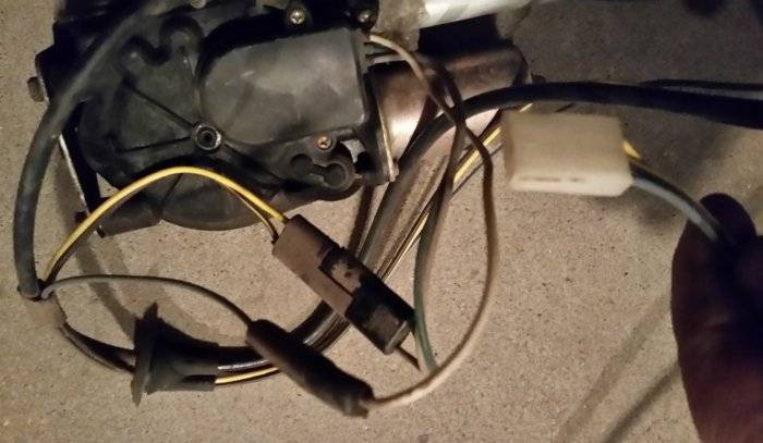

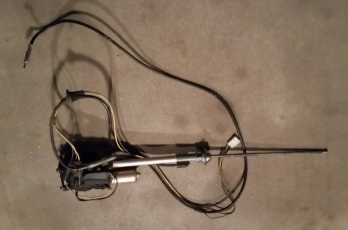

Took Darth-Car's antenna apart and pulled the mast cord gingerly out of the gearing.
Well guess what... the fine looking aluminum tube I put on the end of the cord, crimping the end, is too soft to act as a firm stop. After about 5 or 6 times, the aluminum just straightened out and pulled away letting the cord spin free.
Well damn. It was a very pretty solution..up until it failed. lol
I'll get some pictures in the morning and show you the problem.
Here all this time I thought it was the limiter.
