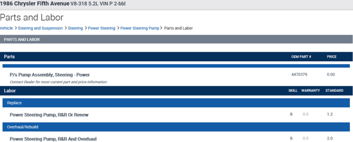

This is from my Alldata labor time guide (what a repair shop "should" charge a customer):
If you can't read it, it says 1.2 flat rate hours to R&R (Remove and Reinstall or Remove and Replace) and 2.0 flat rate hours to Remove/Reinstall and Overhaul).
I didn't know what car you have, so I used my '86 Fifth Ave for the time (which has A/C and A.I.R. pump).
Below is repair pages from my '77 FSM (Factory Service Manual) - which is exactly the same as my '86 FSM. You do no need to perform an overhaul to replace the front shaft seal.
I would recommend replacing the can to pump seal O-ring though. That O-ring (can to pump) has given people problems over time, enough so that I would replace while there, I wouldn't go any deeper than that, though.

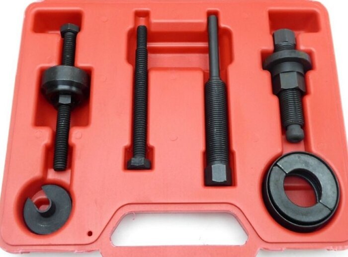

Removing (and re-installing) the P/S Pump pulley is the hardest part – but that is not difficult if you have a pulley tool. There are several different versions out there and this is one version:
Our cars use the GM Saginaw P/S pump. If you find a tool that works for GM pumps, then it should work for you, as well.
2,992
Some parts stores have rental or tool loaner programs and they should have a kit similar to the above. For those that may do it themselves only one time, it doesn't pay to buy a kit, although they aren't all that expensive.

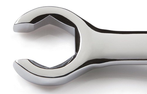

The return hose uses clamps (flat spring clamps) and is low pressure.
Both ends of the pressure hose are hex ended and requires use of an line wrench (and not an open-end wrench) to remove.

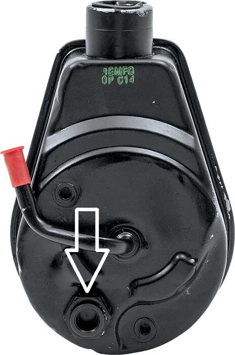

To complicate things, there is a fitting (painted black, to match the color of the pump) on back side of P/S pump that sometimes likes to unscrew when removing the pressure hose from pump.
If that fitting is trying to unscrew, use a backup wrench on it (open-end is fine on the larger fitting). Sometimes, a person can use a crescent wrench to hold the fitting in place with a line wrench on the hose - but most times the clock position of the larger fitting prevents that.
If the large fitting loosens, one can just re-tighten it back after line is removed and call it a day.
