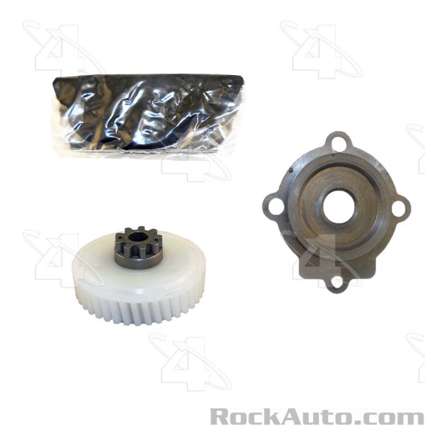

I think that's what the kit is with the plastic/metal gear. From the photo's on Rock Auto, it looks like the gear and the metal part under the gear with the "pucks", and a new clutch cover are included..

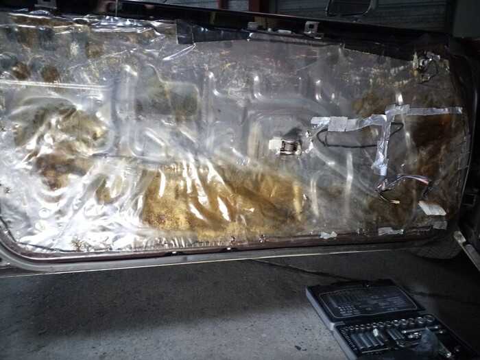

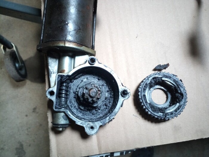

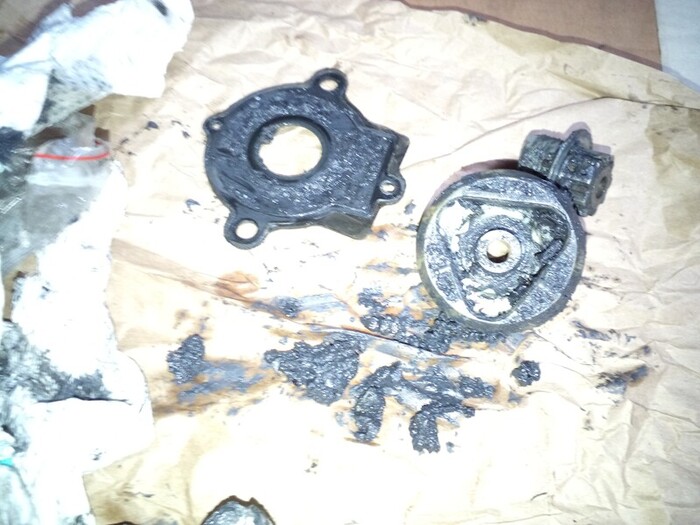

So, today I had the opportunity to fix it. It was as expected, the nylon bushings were "gone". Cleaned it all up, new gear (said set) plus all and a lot of grease, works fine. *thumbs up* for your help and the links.
I had to remove a couple more parts to get the door panel off (light, upper trim) and there was a rubber piece along the lower end of the door - is that original? Have no pic at the moment. The shield between door and panel -> of course put in place again.
Had no butyl line available, so fixed the splash shield with some tape for now; will open the door again when it's warmer outside and then do the passenger side as well. :)

Anyway. Re-did the splash-shield with a butyl-line and fixed cracks in the plastic. Also corrected the routing of the wires through the correct hole. And I put the secondary sound seal in place (the rubberish part at the lower door end) - what a difference in "street sound"! Amazing. :cool:
The brownish glibberish on the splash shield is conserving stuff put into the door. That one will not rust. :)

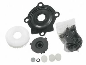

And on a side note, I'm working on a '88 LTD Crown Vic (for my niece) - the rear door window motors had the exact same problem: window not moving, but motor turning. Turns out, that it's exactly the same thing inside that motor. Didn't compare both parts, but it looks interchangeable (second pic) :eek:
Only difference: The ford part on the rear passenger window was only 33yrs old, while the LeBaron driver side held up 42 years. And the LeBaron is w/o AC while the LTD ran in Arizona and had AC. Assuming that the driver side in the LeBaron was used much more than the LTD's rear window. Further, the door panel of the LTD has to be drilled in three locations to remove the window motor, while the LeBaron has no need for metal works....
