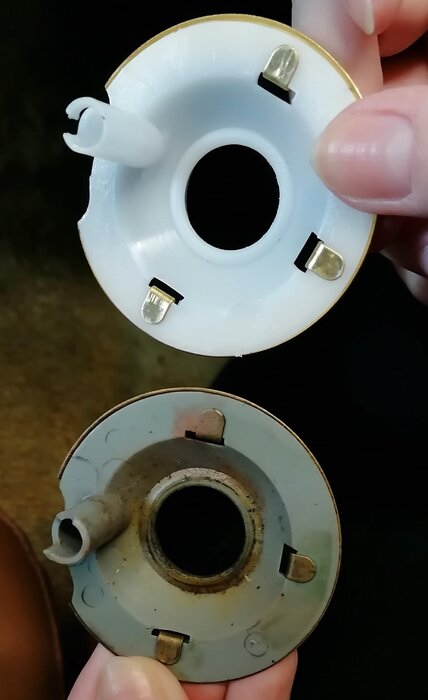

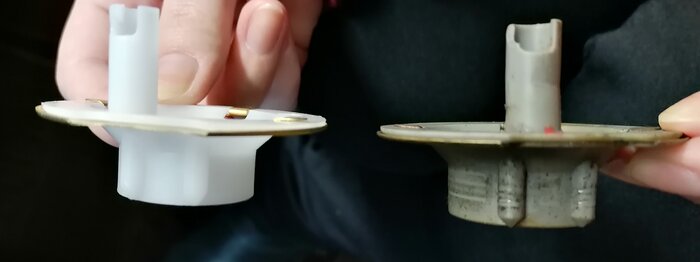

Finally I can give you some feedback on the cancel cams.
Yesterday I finally had the opportunity to test the installation of the GM aftermarket spare part.
It looks pretty much the same except for the quality of the plastic. The original plastic seems to be much stronger than the new one - lol.
It fit really well in the column.
I haven't been able to test drive it yet, so I can't give a final review.
But for now, I would say that the GM cancel cams are good replacements.
See the pictures.

Glad it worked out for you. Interesting, as far as the quality. Are you sure it is a GM part or a aftermarket replacement? I would think a actual GM part would have been the same good quality.

Hello guys,
I finally could test drive the car with the cancelling cam. It works pretty good. I don't feel a difference. The switch flashes and also stops automatically and the horn contact is firmly seated. The horn also works.
Thank you again for your help!
It makes sense it works since it's essentially the same column that gm used.
