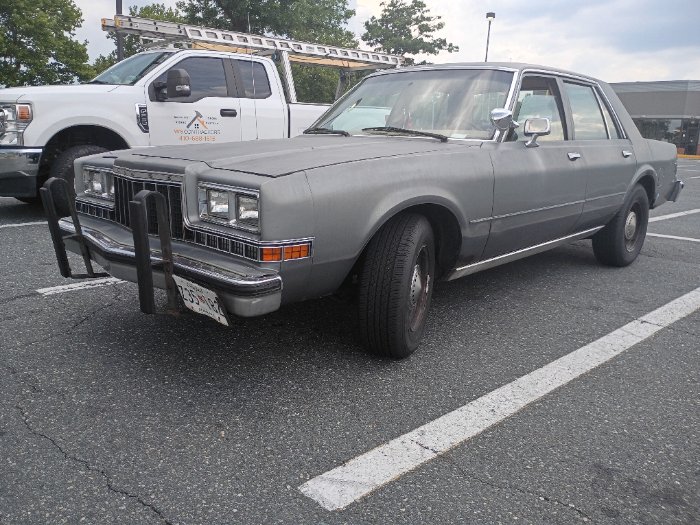

It's been a long time. work and life has been getting in the way. but the old boy is still here.

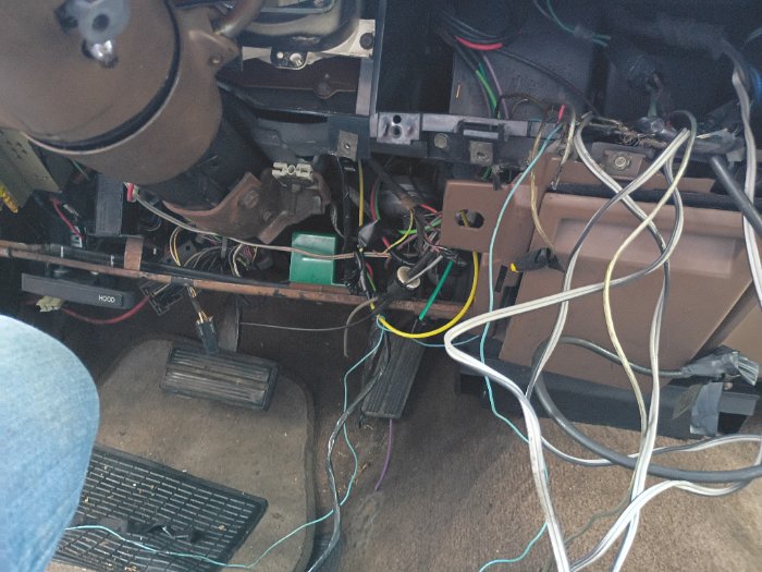

he's been running pretty good. currently i've been sorting out the wiring mess this car has. someone put a subwoofer in this car and there is no reason to have this many wires in here. holy moly.
he's blown coolant hoses on me twice. but once was my fault because i had put a heater hose on that was too long and got eaten up by the belts. still leaks oil but i've narrowed it down to the driver's side valve cover. other than that not much going on except me going back and forth to work.

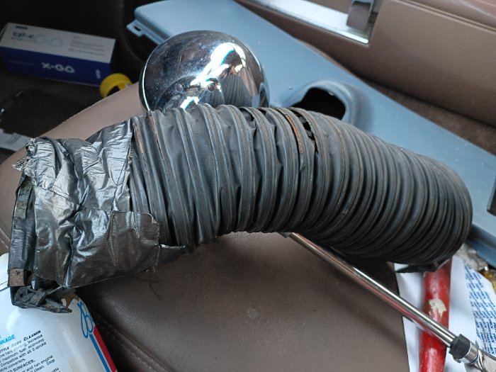

one more thing. anyone know where to get the air inlet hose for the 4 bbl air cleaner? mine disintegrated.
i seen numerous online that have these put together with duct tape, i feel lime Summit had these but i can't find it anymore
one end is square, other circular
