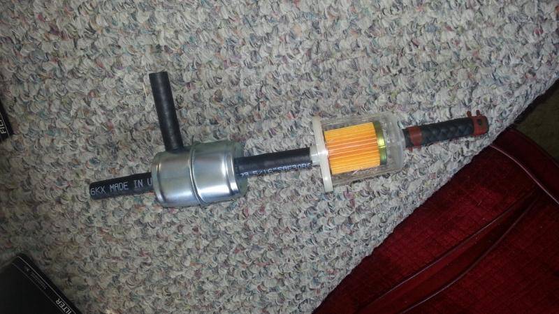

Someone mentioned a daisy chain fuel filter... is this what they meant? If not, how do I correct it?

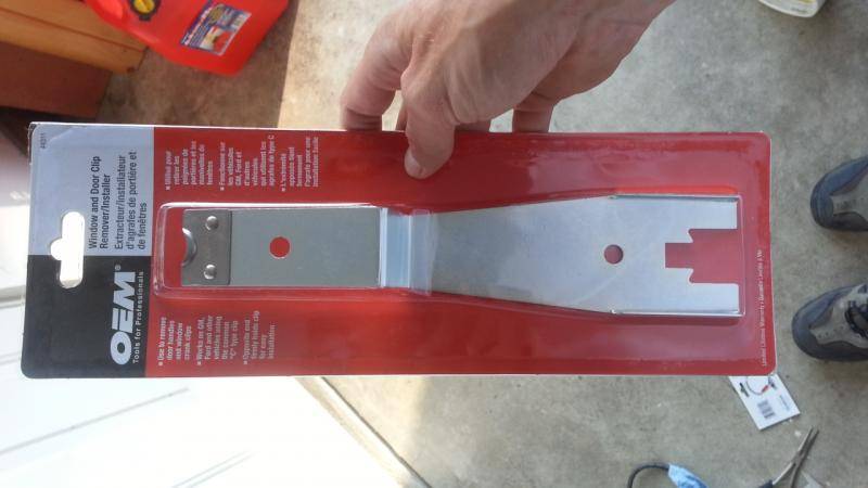

As well, headliner fabric is on order and am looking to fix that leak in my windshield. Is this the correct tool for a Chrysler?
That's a good start, Thanks Captain.
As for the trim tool, i can still return it. I am contemplating returning a radiator flush kit I got too. Its Rad Rescue which has the T fitting for your hose to hook into the lines and flush out your coolant. The lack of directions has me apprehensive about trying it. Anyone used a Rad Rescue kit?

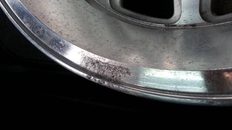

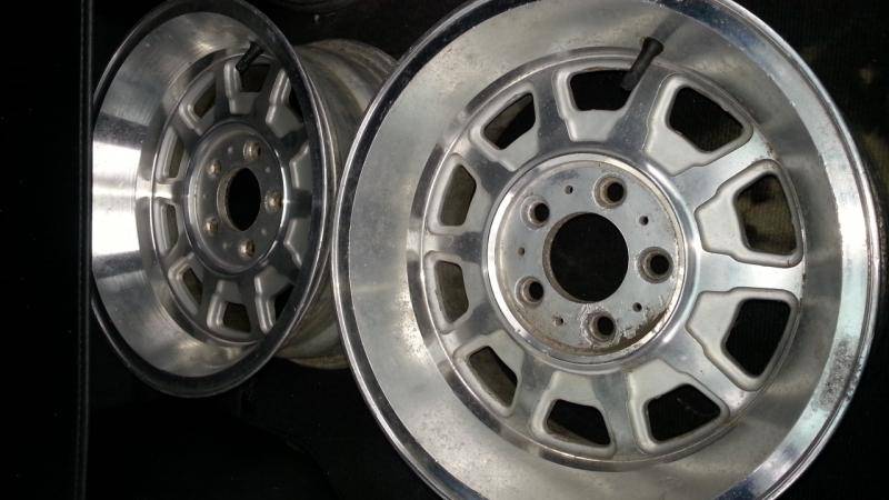

The aforementioned wheels i scored for $75 are attached. They're pretty rough. The pits are deep and there were s corrosion on the lips. One wheel has a bit of a spot that may be bent... just not easy to see - maybe its not critical. Does anyone have any suggestions for how to approach these wheels? Worst case as I said was a fill and paint. I only have $75 into them but can't live with how they look so rough at present. The nicest part is the part you're not supposed to notice haha.
Any tips are appreciated. Thanks as always everyone!!
I have seen a lot worse when it comes to wheels. For the price, drive them like you stole them. Use them as winter wheels if you cringe at the looks.
Wait... You drive your car in the winter??? LOL.
Yeah they're not the best or the worst. Just trying to figure out what direction to go. Maybe a 400 grit sand job and work up a bit.
I changed the fuel filter out... there isn't much room for the daisy chain. Maybe I did it wrong... but its hooked up and can see the clear filter okay, not great, but better than nothing.
