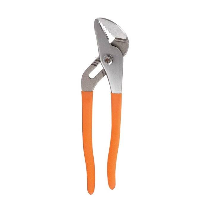

Using this kind of pliers
I can usually get the adaptor out (with cable still attached to adaptor) using one of two different methods:
- Grabbing a hold of one of the adaptor reinforcements, I can generally rotate the adaptor (gently) in its hole (will only go a bit in one direction – more so the other direction). After I get it to rotate a bit, then generally rocking the assembly gently, the assembly will pop right out.
- The other method is to grab ahold of the cable with same style of pliers and using the cable to gently rock the adaptor out – but I will say this method damages the speedometer cable more times than not.
I think that you are not going to re-use the cable – if I recall correctly.
- There is a third method – which is what Aspen500 mentioned, and that is to remove the transmission extension housing, then with a pry bar, to pop the adaptor out from inside out. This works better for the metal adaptor as the plastic ones get damaged fairly easy. Use this method as a last resort (a lot more labor intensive).
Tip: when you reinstall the speedometer adaptor, use plenty of ATF on the seal. It goes in a lot easier and makes removal a lot easier.
