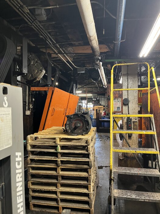

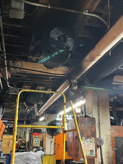

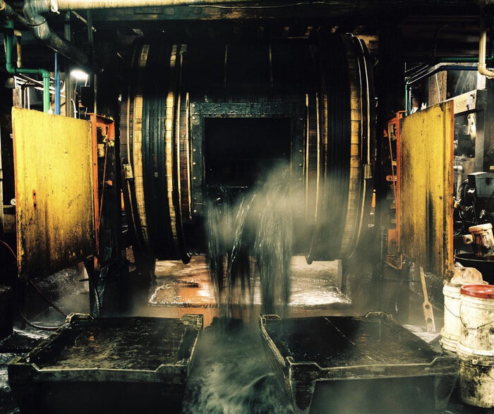

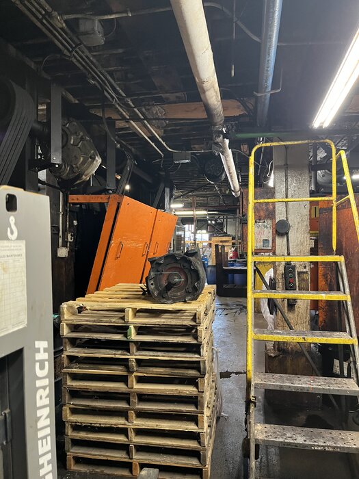

Motor went out on one of our color mills. Gotta get this 500+lb motor off the ceiling. Fun day at work; at least it’s not Monday.

Stack pallets, lift pallets with forklift and pin the motor to the pallets, unbolt motor, lower down…unfortunately, this is an “easier out than in”, situation. Getting the new motor to line up and bolt up will be a pretty good challenge tomorrow morning.
How often do these things fail?
Most of the motors for the mills have been hanging from the ceiling longer than I’ve been alive. These old Sterling motors are pretty beefy. The Dodge gear reduction box that the motor drives, get rebuilt every 7-10 years or so, depending on when the shaft seals go out and start leaking oil.

Should be easy to line the new motor up. Can't weigh more than a few hundred pounds. Just muscle it into place, lol.
It’s not too bad. Put some plate metal onto the skid, put motor down onto skid. Give me something to slide it around on when I lift it up. I can only take the lift straight up and down, have a gear box on the left and a water line to the right so, I can’t particularly use side shift/tilt or anything to help get into a better position once I’m raising up under the mounting plate.

I'd be drilling a hole in the floor above, put a gantry or some kind of winch above the hole, drop a line down, and lifting it in place through the floor above
I don’t think the owner would appreciate cutting through the joists and support beams that hold up the office floor because, that’s what the motor is hanging from. 2 4x10s bolted to the joists and support beams for the office floor directly above on the 2nd floor. It’s an idea though.

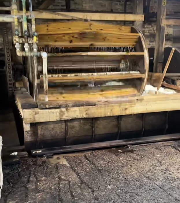

Imma take a picture of the motor next to my hand tomorrow, lol it’s an idea. It’s a 25hp motor, these mills hold about 2k lbs of leather and another 5K lbs of water when a full load is running.
Interestingly, to some, there’s not really anyone left in the world who makes these old wooden leather mills. There used to be a guy in, Milwaukee who’s retired, there’s an old gentleman in, Italy who is still building them but also, in his final years of work. We have an old Polish gentleman who can rebuild them but, he retires at the end of the year.
The modern molded polypropylene mills just don’t deliver the same quality finish as these wooden mills. These have wooden clubs secured inside them that beat the leather allow the water/dye/oil/wax/ect…to really penetrate into the hides. The modern mills are plastic injection molded and instead of clubs, use shelfs/paddles and they have way to much surface area. So, as the mill rotates the leather ends up falling in stacks onto the paddles/shelves and stick to one another and you don’t get the same penetration and finish quality at the end of a run…interestingly, we do specifically use hand made wooden paddle mills in our pickling process.
Paddle mill vs color mill

Color mill. For a size comparison next to a couple men.
We have three different size mills. The color mills are the mid size. Large are the Chrome mills where we make our blues. The stuffing/dry mills are the small mills of the lot.
