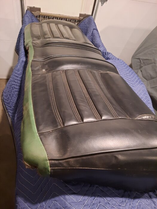

Found something interesting when the seat came out. The back of the seat bottom is upholstered in green vinyl, while the rest of the seat is black. Still has the "Chrysler Corporation Central Soft Trim" tag on it though, so I think that's just the way it was made. Maybe running short of black pieces that day?

For the hidden areas, they sometimes used whatever scraps they had on hand. I've seen all sorts of that type of thing over the years. Guess it was recycling before it was a thing.
