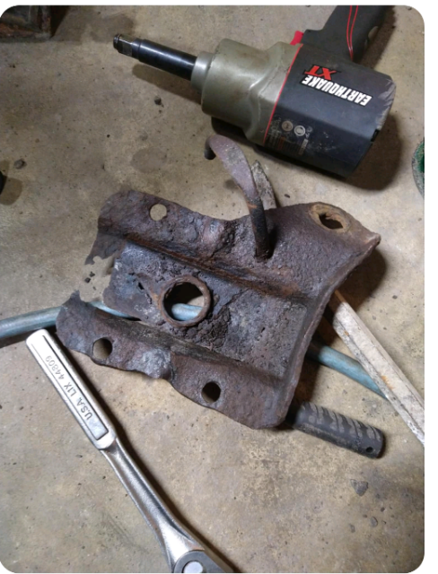

SO we sourced the lower plates and poly biscuits....
Turns out the upper plates/shock mounts are trash too......
Soooooooo......anyone have a set they wanna sell? LOL
Or are these "unobtanium" ??
I had the shock mounts snap off my old high mileage 5th Ave after many years...rust and metal fatigue. They are not available new I had to get mine from a scrap yard.

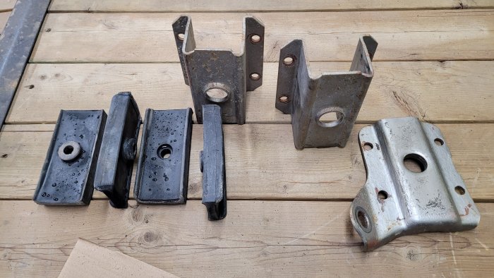

b-body shock plates brother. Ditch the goofy ass ISO and top shock plates. order some B-body plates, centering pins, u bolts, shocks and call it done. The FirmFeel shit is way over priced for what it is.
I've got an "appointment" in the garage later tonight...let me look for these. I know I have a set with the sway bar attachment brackets and I'm going to keep those, but I honestly thought I had saved a spare of the standard plates. More to come...
