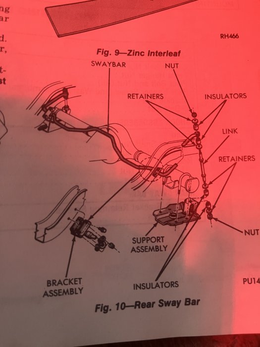

M_Body_Coupe
Aug 19, 2013
797
366
Windsor, ON, Canada
For what it's worth, may I suggest it is all about this ROD in the picture...
YES !!!! that is it. That rod contacts the back of each side of the shackle. Rubber bushings insert through the "tube" above the rod as well. The pic is upside down in regards to how it's actually bolted to the upper rail. Thanks for pic !!
So the weird part to me - which is what I have been thinking all along in this thread - is that I have never actually seen a set of F/J/M-body leaf springs that actually extend the shackle back so far that is hits the dead-stop bar!
That would just seem like the leaf spring is too long actually...no?...or perhaps it's lost it's arch so much that when nearly flat it is actually extended that far.
EDIT
SCRATCH all of the above, I had my frame mount visually flipped (in my mind)....the rod blocks the rear spring eye from flipping in FRONT of the mount when the suspension is completely unloaded!!! Kind of a 'safety-stop' I would think.
