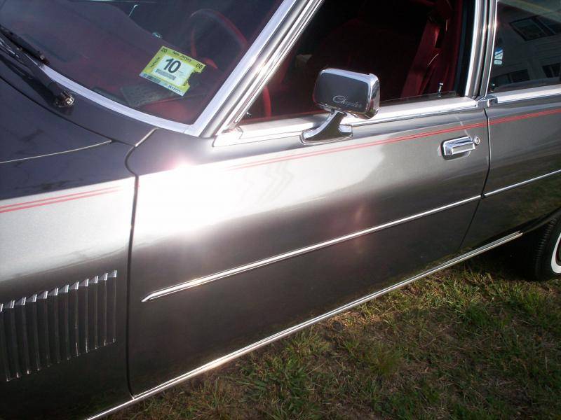

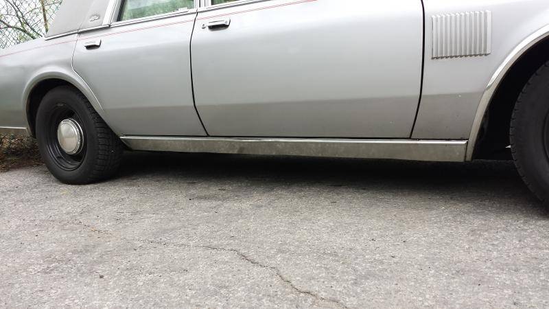

I am working on restoring my grandpas 1984 fifth avenue it's dark brown with dark brown carpet and tan lather seats. and I am trying to track down the chrome rocker molding that goes under the doors and between the wheel wells for the passenger side of the car. I've gone to body shops, junk yards and Chrysler dealers and have come up empty handed. I have the new rocker moldings that stick on but it's not really what I want to put on the car. I'd like to put it to how it was the day it rolled off the line at the plant. If anyone could help me find one please let me know. Thanks.
What are the exact names for these items and what do they look like? I'll look.
10,745
1,205
Rocker trim/moulding.

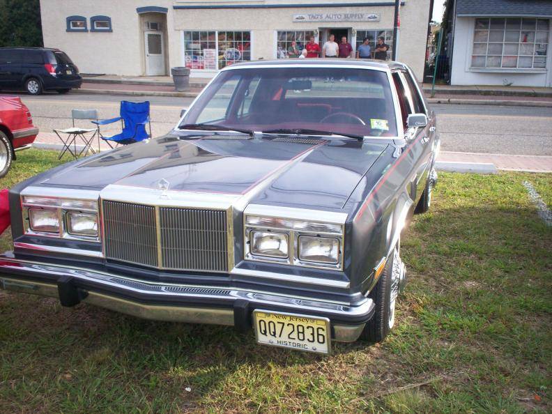

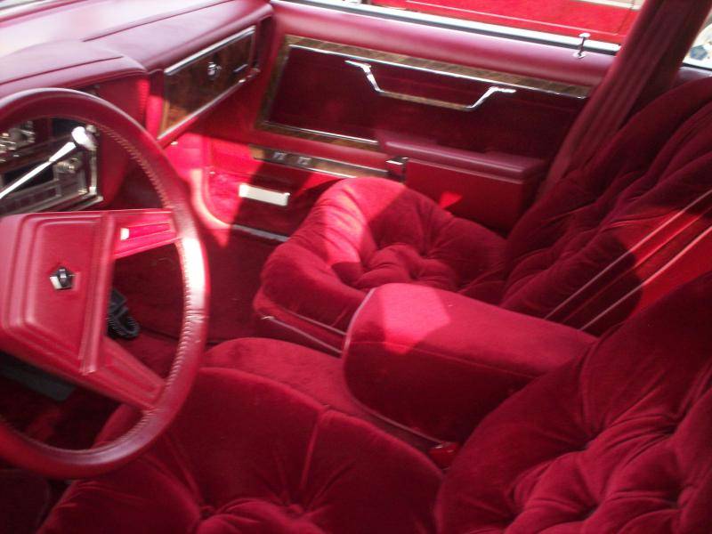

I run into this old couple every year at Glassboro carshow on the Friday of Labor day weekend. I have some more pics of this sweet 5th, but this is what you shoot for in getting a 5th "Show quality"
