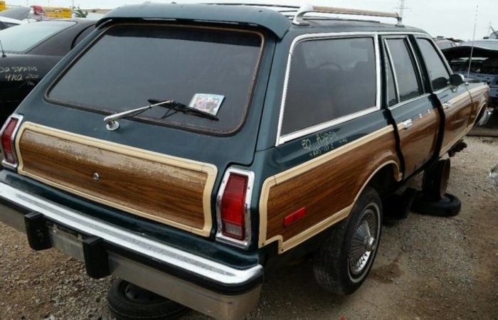

It is hard to tell, but this ’80 Volare wagon has chrome sport (or bullet) mirrors on it – which appeared to be original, at a local pull-a-part.
I went back to the car to get the mirrors and some yahoo had taken a crescent wrench (I think) to the upper door panels and pulled them outwards enough to get hands between the outer and inner door skins (ruining both front doors (and trim) in the process). Then took wire cutters and cut the cables! On both doors!
