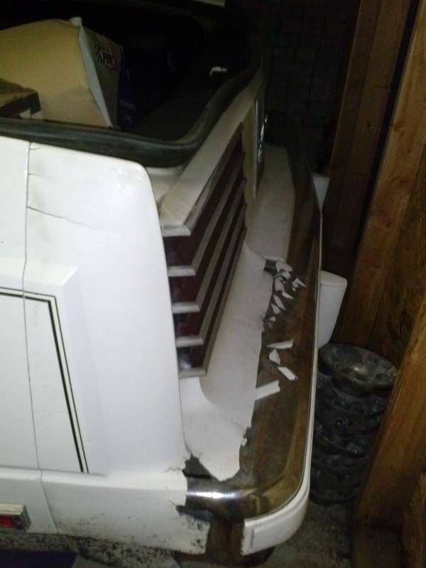

Im still working on the left side extention the body work is coming along but slow . The dr. Put a damper on my way of life and had to make a few changes losing weight will take care of most of it .here is a photo of where im at
Thanks guys the reason this is taking so long is you can only work so many 16 hrs. days and wrench when the time permits (none ) it's still happening i promise
