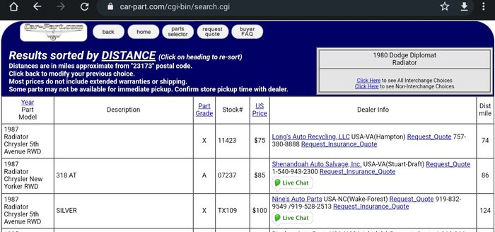

I don't know where in Virginia you are but here's what's on car-part.com

Lightning ll, good info..Can I get that in aluminum, should be able to don’t you think? Will that be enough cooling for a high performance application? Thanks, much appreciated, Jim..

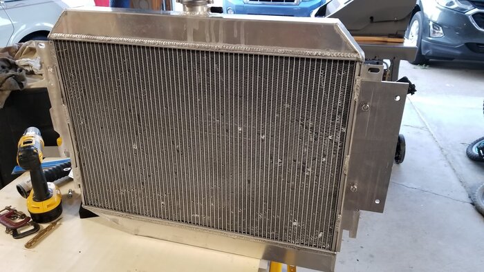

Champion CH374 fits a 26" core support. Just needs a plate on the drivers side as the mounting ears are a little short. The one pictured is the 3 row model. If you have a 22" radiator I've got nothing, but Champion might still have something in their catalog that fits.
Ignore the lower radiator inlet. I had this modified by a local shop when I swapped in a big block.
