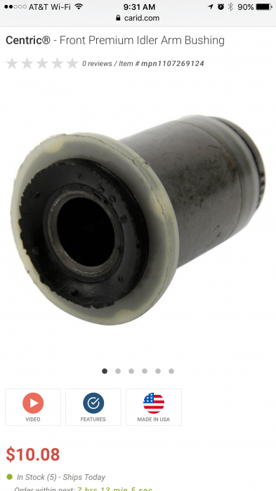

Anyway, so where the idler arm attaches to the "center link". The bushing... I can't find it. Anyone got a part # for this?
Rockauto only has the idler arm, which doesn't come with anything for the center link end.

I think this is what I need for that end right?

Most Idler Arms have rubber bushings on both ends and there is not (much) to add grease to begin with. A few Idler Arms have a ball joint on outer end (Center Link side) – but not many.
Yes, a replacement rubber bushing insert is made for the idler arms - but for cost to replace the whole thing, doesn't make any sense.
That's what I was thinking, but just looking at the pictures it didn't look like the arms came with the bushing at the center link end. So if I order the Moog idler arm I have linked here, that comes with everything I need?
More Information for MOOG K7086
1,492
It "should" come with the arm (with bushing pre-installed), a castle nut and cotter pin.
