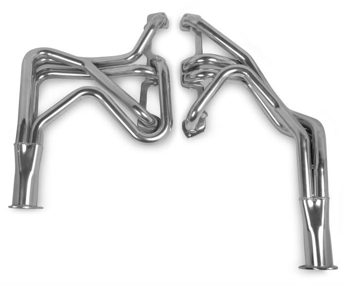

I ran these on a Fifth Avenue with a small block. All F/J/M platform cars have the exact same under hood layouts. They fit well, but you'll see from the picture the 1,5 & 7 tubes go under the steering link. It's very easy to contact the ground with these style headers. Depending on the road conditions you might be OK. In Michigan, not so much.

I used a cheap set of, Summit Racing headers for an A-body. Fit is fine but, like the Hooker headers, you have to run the steering linkage through the primaries of the drivers side. Only clearance issue is with the ground/speed bumps particularly; typical long tubes hang low. TTI and Doug’s don’t have the linkage or ground clearance issue.
