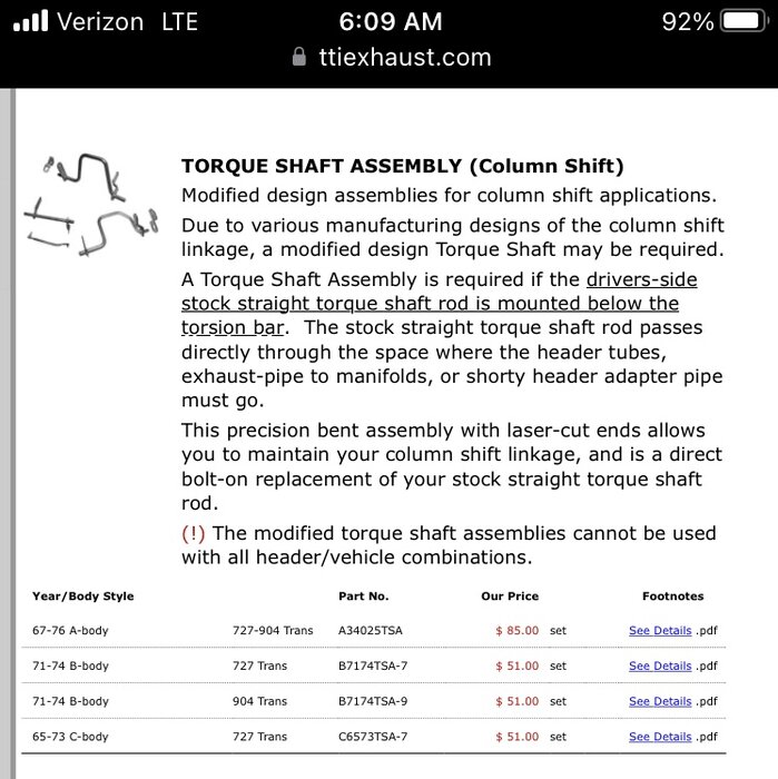

I guess your shaft will work (LOL) as TTI doesn’t list a modified shaft for FMJ applications.

I agree TTI has them for F body as others wrote. And they fit my M body great which is very similar.
4.
1-5/8 x 1-3/4" FULL-LENGTH STEP HEADERS, 3.0" collectorsHEADER NO. 340
• Applications: 67-76 A-body, 62-79 B-body, 70-74 E-body, 76-80 F-body, 77-88 M-body
• A/LA-Engines: 318, 340, 360, 402 crate, 408 Magnum crate, 440 Super commando crate
• Cylinder Heads: OEM or Equivalent - Edelbrock Performer RPM, Indy-TA, Mopar Perf Alum, Mopar Perf cast-iron, RHS-Indy360X, Trick Flow
